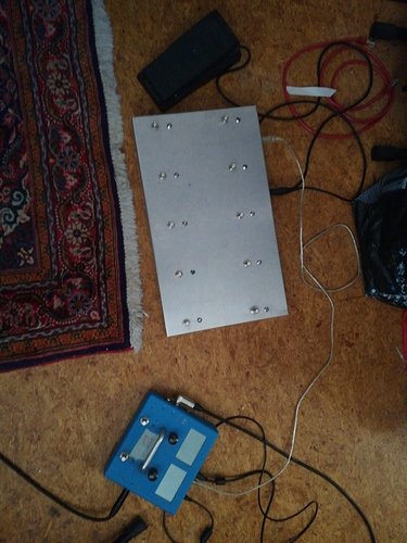

Build your own :slight_smile: I used a teensy 3.2 in this and hooked up two ADC’s to two stereo jacks at the back of the unit. There’s only one exp pedal connected right now since I own only one ;)The 10 buttons are just triggers and send CC’s. The nice thing is it’s completely custom programmable to do whatever you want.
The single most expensive part of this build was the housing :wink: All in all it’s about 100 euros or so.. Oh and about a week of your time if you’ve never done it before :slight_smile:

Ouah that’s really impressive.
I’m not familiar with all this, and I do not understand it.
I assume the USB cable coming out of the Mod goes in the Teensy, and then I’m lost …
  • you plug all 10 switches on the Teensy, and they send a Midi signal on USB to the Mod (that’s standard library ?)
  • I’m not sure about the ADCs, there is no sound right in this setup, only angle of the expression pedal ?
  • you are not using the arduino shield right ? I thought that was what is was for :smiley:
