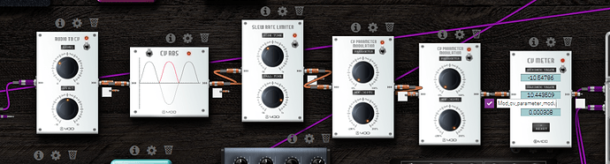

Here’s what I tried.
Audio to CV plugin, CV ABS to trnsform negative values in positive values, then CV parameter modulation to amplify the CV signal and set a offset.
I’m trying now to find a way to compress the CV signal to have a stable CV signal.
Ok I get a pretty decent result by adding the Slew rate limiter plugin in the Cv signal chain , here’s the way I’ve done it.
You can add more "CV parameter modualation to amplify the CV signal.
Here’s the pedalboard.

Look this new pedalboard! I manage to control plugin parameter in positive and in negative way. Unbelievable. Doors are opening! :pray:

In fact the two “cv parameter modulation” module only amplify the signal. Each plugin value you want to control will have it’s “Cv parameter modulation” module.
In the “vc parameter modulation” module, the “parameter” value will set a offset or it can be use to set a value if you want to use manual mode, I’ll will explain what is manual mode.
The “Mod depth” value will amplify the signal from 0 to 200% in positive or negative way.
To go to manual mode just switch off the “audio to cv” module.
