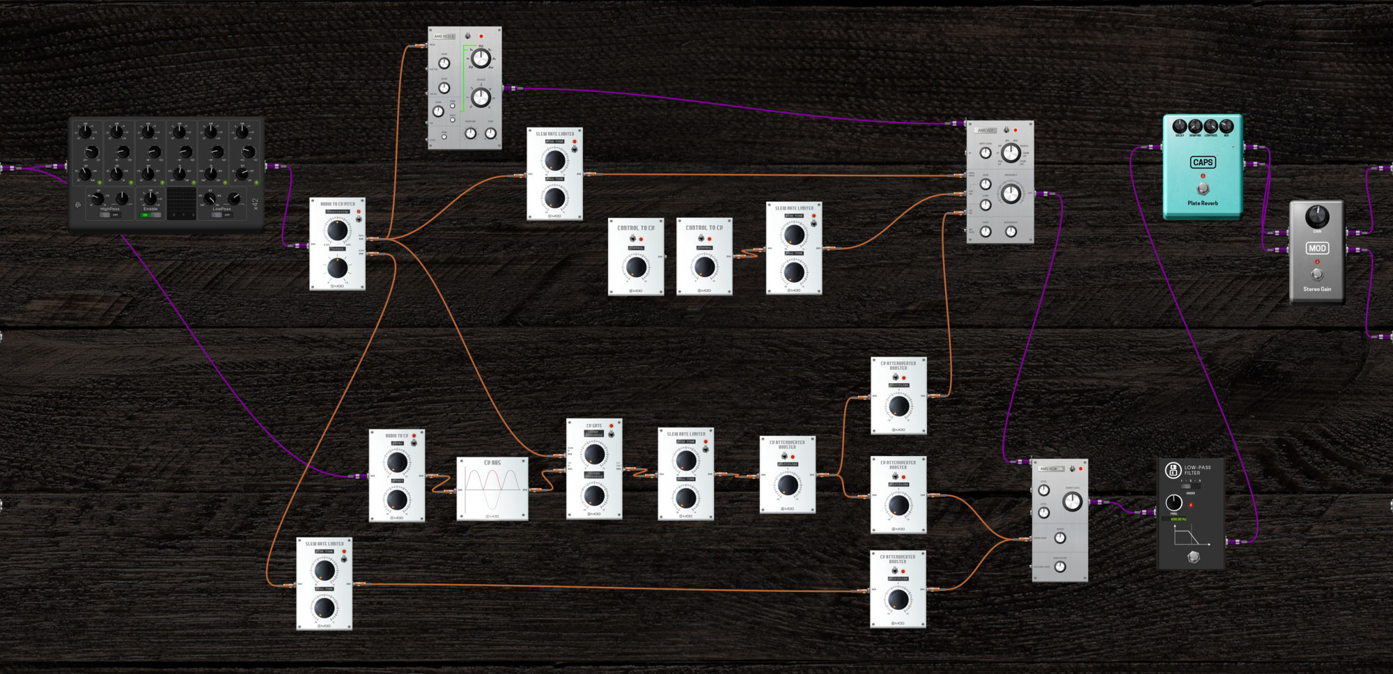

For a more proper CV synth there is a minimal Guitar Synth board meant for the Duo that could be act as a module in a bigger board:

Audio2CVpitch does not feel to track bass strings well (but that’s the same as on C4 guitar synth I guess)
You can use the Capo to shift it one octave up before, so that it tracks better. The AudioToCVPitch has octave control, so you can compensate for the shift up
in fact I am taking my issue on the head: I am using one of Jesse’s synth and I am adding a little “classic” audio path to play my regular bass sound. That does the trick.
