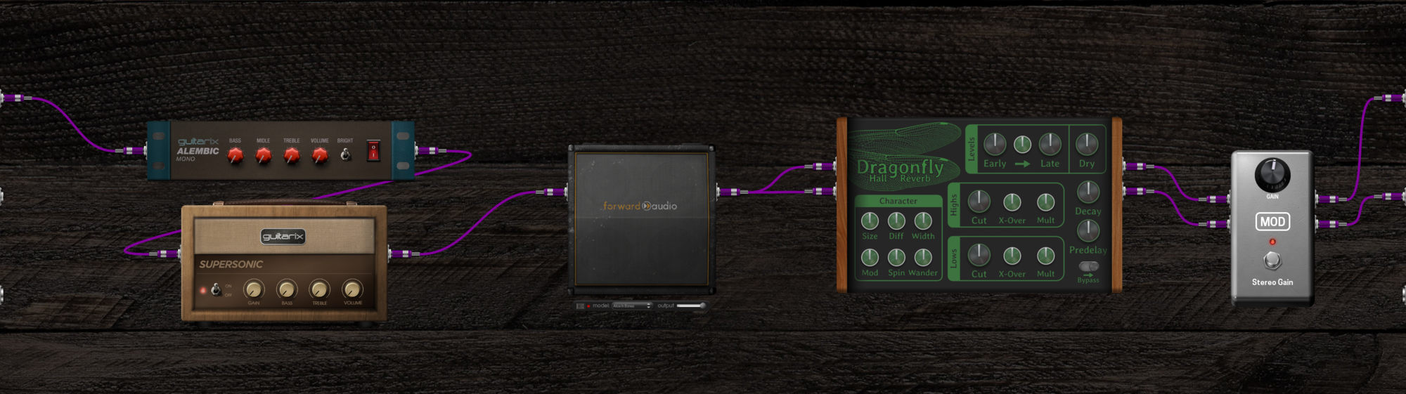

I am now using a Guitarix Amp-X simulator with an expander in front of it setup specifically for my guitar. This basically increases the dynamic range of my guitar from soft picking to digging in to be larger and then this can drive the amp and force the emulated tubes to distort as I want when digging in.
I also had to add a compressor after the amp to try and undo some of what the expander did as the natural compression offered from overdriving the tubes doesn’t seem to cover enough of the variation added by the expander.
The amp sims available (I tried all of them) do seem to have this clean to crunch in the emulation, but it seems the range of my guitars output level just isn’t dynamic enough to cause the sound I want on its own.
My solution does still have some issues with the way the expander/compressor works I dont get the same breakup on individual notes digging in and I haven’t tuned the attack to my liking yet. It doesn’t pick up digging in on individual notes as well as it does chords. I am guessing I need a compressor/expander that uses peaks or something different for the level envelope. I might take a look at the CV option described above and see if that is helpful.
