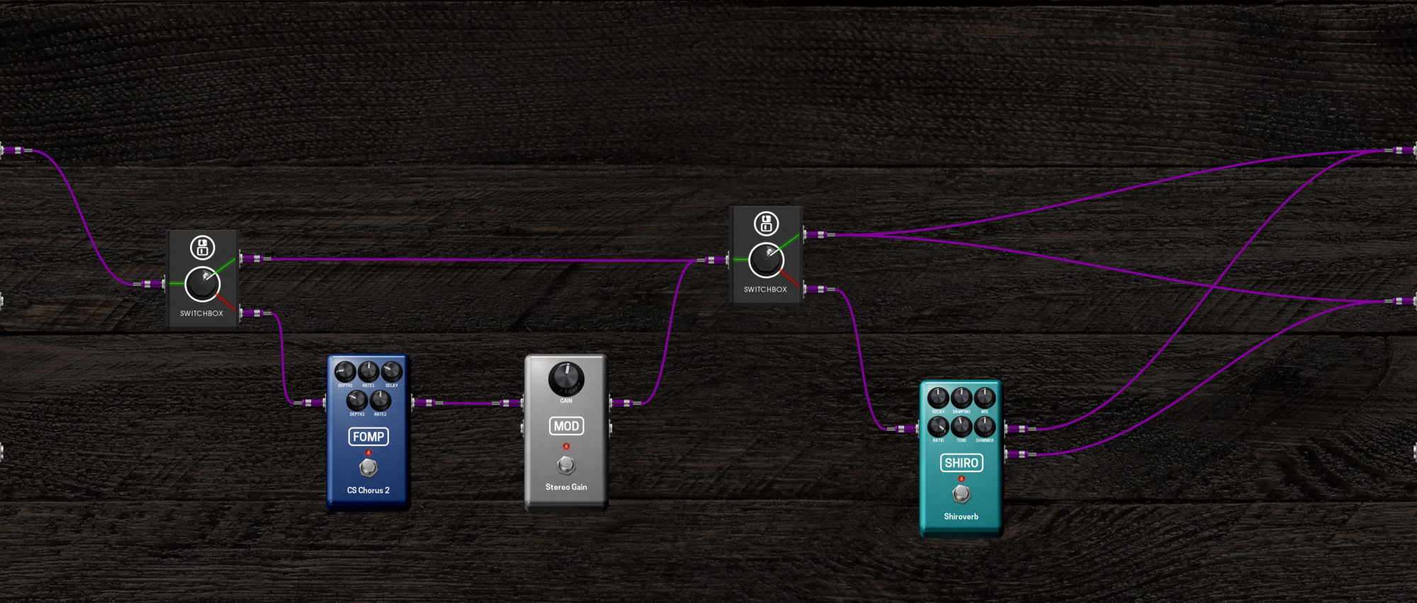

Hi @Sharry
Here is a simple solution where you let the pedals ON, you just send the signal through it when needed :

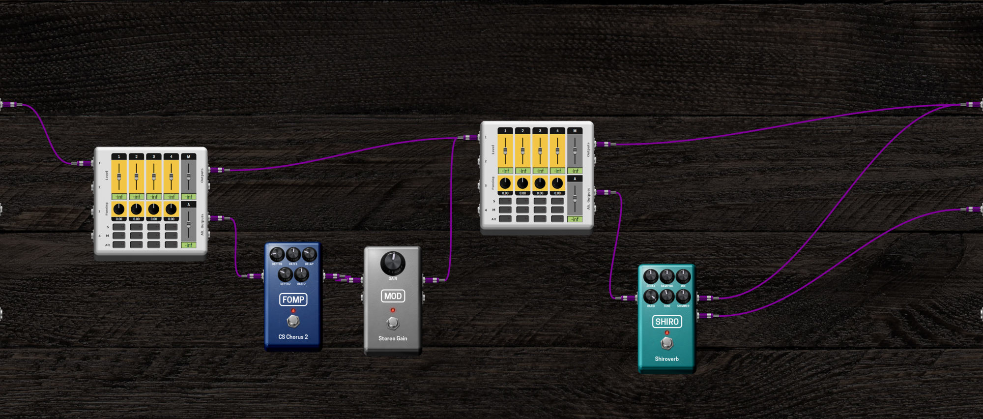

And this solution to see clearly the states of the sending with the footshitches :
With those solution you can get the trails of reverbs or delays.
Does it help ?
Thank you very much for this suggestions.
I think this will help. I will try it out today or tomorrow.
BTW: The mixer integration seems to make some other interesting applications possible.
Update:
First of all, switching effects in parallel instead of in series, as is usually the case on pedalboards, also produces a good sound.
With the mixer and the level meter, which I also found in a thread today, I have now found a way of working that is faster than I had before.
Thanks again.
Cheers
Harry
yeah, the mixer plugins open an entire world of possibilities.
