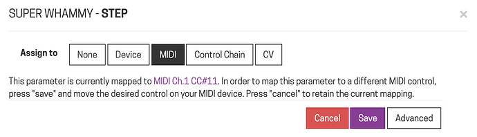

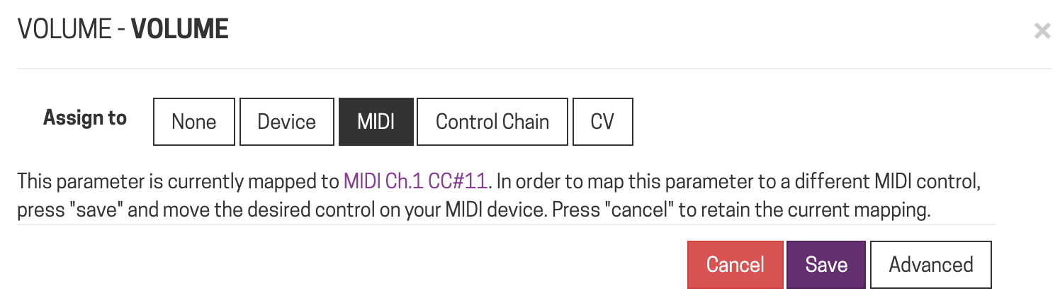

  1. The pedal is a Lehle Dual Expression
  2. CC#11 is Expression Controller
“The LEHLE DUAL EXPRESSION sends the control change command 11 on MIDI channel 1 by default.”
so in the first example it is controlling the pitch of the Super Whammy,
in the second example it is controlling a MOD Volume 2x2
