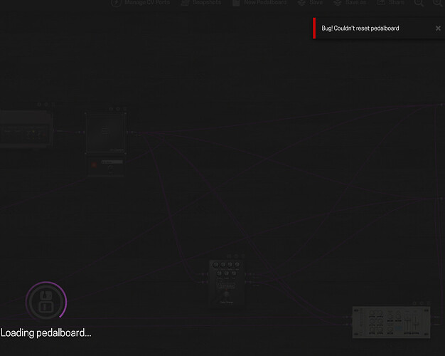

Turned on my Dwarf
launched WEB GUI
last used pedalboard was successfully loaded and working
clicked on New pedalboard
this error happened
now I’m unable to load any other pedalboard from the WEB GUI (even after a reboot), same error appears
then closed the WEB GUI and rebooted again the Dwarf
once rebooted I changed pedalboard from the Dwarf (without launching WEB GUI)
now everything seems working correctly

Happened first time today. It seems working now. I will report it if will happen again.
One thing I noticed is I was launching the WEB GUI with the previous version as URL parameter (old saved bookmark)
http://moddwarf.local/?v=1.10.1.2234
instead of
http://moddwarf.local/?v=1.10.2.2336
From now on I will use http://moddwarf.local/
