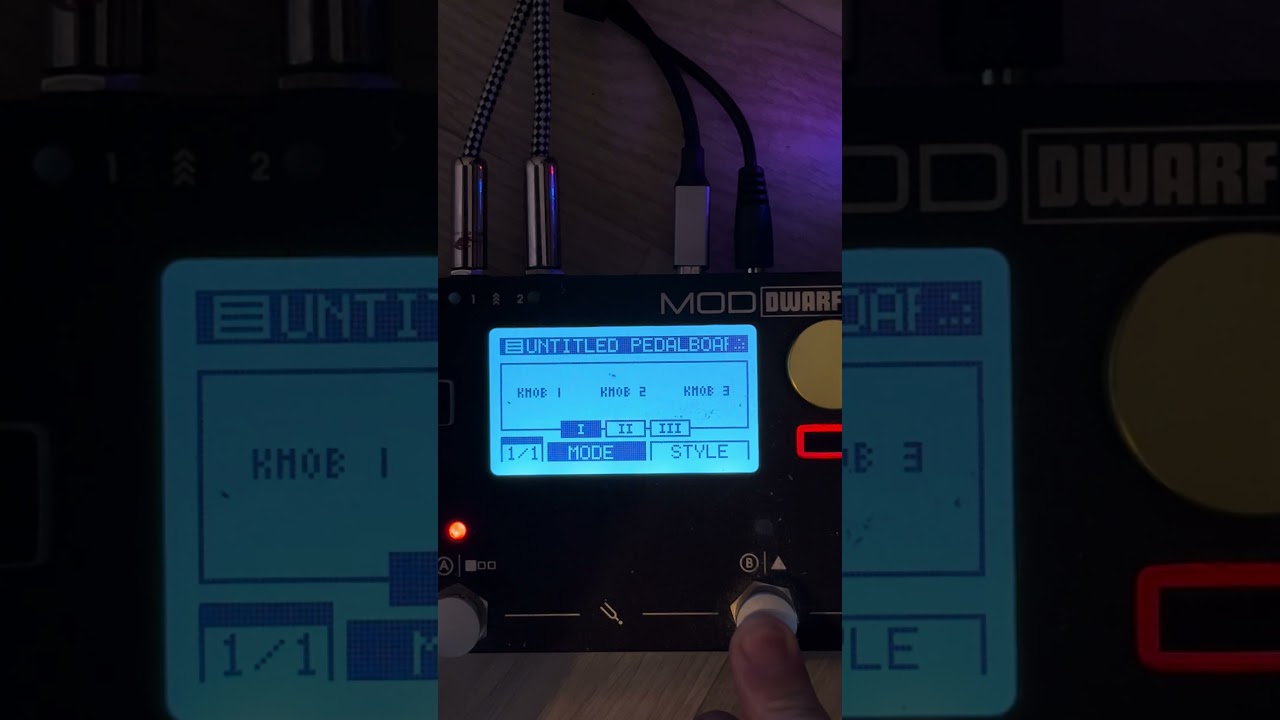

I’ve made a Tuner plugin for Dwarf. I know that there is yet a tuner but, this one is a test with the name of the Switch. Have a look at this video :
Find the Plugin here :
The terminal command to install it :
tar czf - dwarf-tuner.lv2 | ssh root@192.168.51.1 ‘rm -rf /root/.lv2/dwarf-tuner.lv2 && tar xzf - -C /root/.lv2 && sync’
ssh root@192.168.51.1 ‘systemctl restart mod-ui’

Wow. So cool. I installed it with WinSCP (copied “dwarf-tuner.lv2” folder to DWARF /root/.lv2). Despite the fact that there are a couple of unclear aspects (the sound is muted when the button is pressed and doesn’t return when pressed again), and the purpose of the “Long ms” and “Probe” buttons is also unclear, this plugin goes to my favorites.
