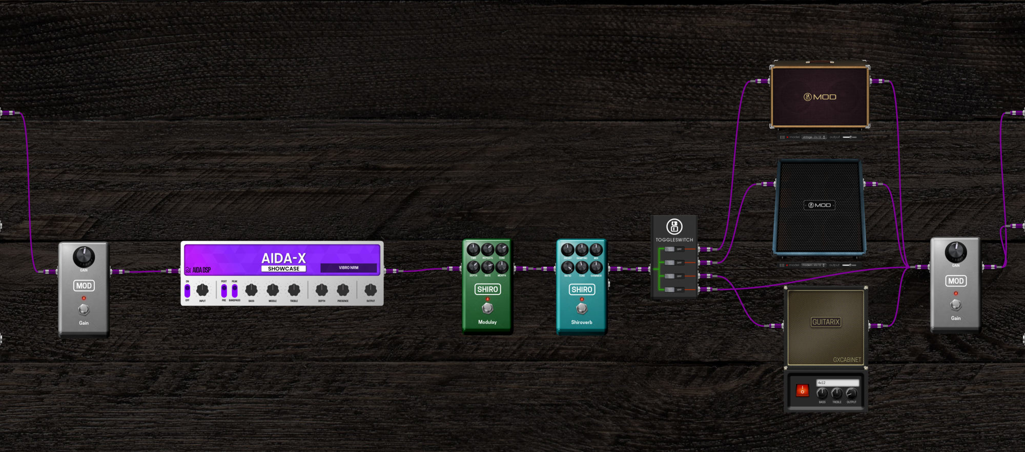

Here’s an example of a pedalboard where those commands fail:
Can someone please install this pedalboard and let me know if those commands work for you? @falkTX, I’m curious if you get the same error messages in the screenshot earlier in this thread.
