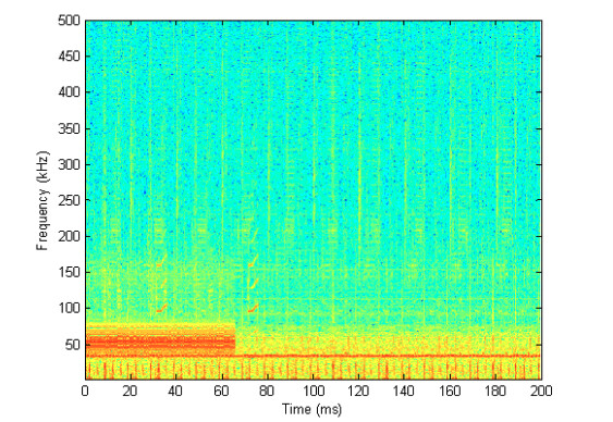

Unbeknownst to many, this alone is a major electrical issue. Other than increasing tenfold the risk of shock, when harmonics are introduced and your polarity is reversed, noise goes up tremendously. If you have fluorescent or low-quality LED lights in the house, much more so.
The graph below is a very low noise power grid in the spectometer:
(Very low noise at around 35Hz. I would say most of our homes would have at least this amount of noise.)
Then you turn on fluorescent lights, and here’s what happens:
(Notice the massive disturbance up until 60 ms. That’s the transformer firing up, but as you see the noise at about 35 Hz that was minimal now is a solid red line and its harmonics go up to 70Hz.)

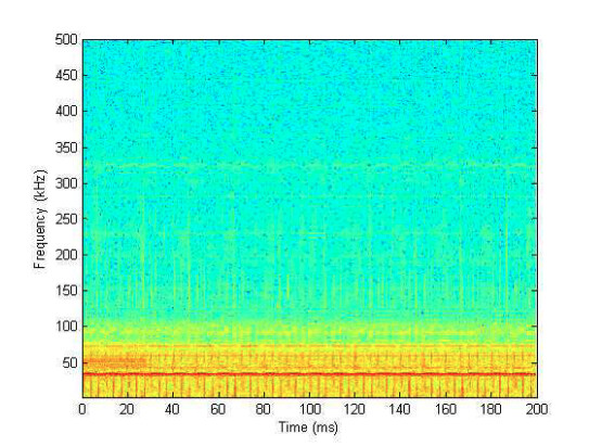

Then you turn on your computer and router:
(Noise is even stronger.)
