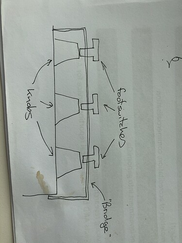

Has anyone ever thought about taking the knobs off and replacing them with foot switches so you have 5 footswitches rather than 2? (or another idea would be to build some kind of 3 footswitch enclosure to go over the knobs so they are essentially just footswtches).
Here is the “3-footswitch-enclosure” idea.
This is not really possible because the hardware inside is different. What you can do is to replace the knob with something sturdy that allows you to step on it. Anyway, it will never be so sturdy as the footswitches and you may indeed break them.
You can always connect an external MIDI Controller or a MOD Footswitch.
We’ve seen people try to make the encoders “foot-friendly” in the past which resulted in having to replace the whole controller board in the device. I appreciate the creativity but in this case, I have to agree with Jon in saying that it may indeed break something. The push-button on the encoder is just a tiny tactile switch that only takes about 600 grams to actuate and really isn’t designed for stepping on.

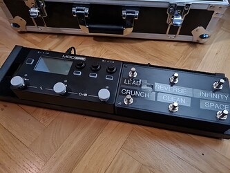

Hej @Ant, another option would be a diy midi controller. Granted you have to have a few tools - and 3D Printer helps but you really just need a few footswitches, some kind of SparkFun Pro Micro (clone) and a case.
I’ve had the same Problem but wanted to keep the size to minimum. I’ll also had to add a Relay for switching channels of my Amp. This is the prototype board i giged with.

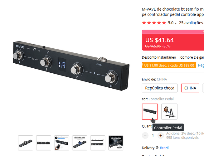

A note: The 17 euros is related to other thing. When you enter on the page, you need select the equipment. See that the price is twice (but also cheap).
Note 2: I couldn’t find the equipment’s website. I’m not promoting with that link.
Hey, did you use the Mod shield? If not, what did you use to communicate your controller with the Dwarf?
No, I didn‘t use the modshield. The Pro Micro is basically an Arduino Leonardo Mini. They are USB-MIDI class compliant. You just hook it up to the usb port. The code needed for the controller is pretty straight forward.

Cool controller Spunk, going to go down the arduino road too instead of control chain.
Did you write your own code or did you modify one. I normally use Notes and Volts for my stuff.
Love the fact the enclosure pretty much matches the dwarf - is it a hammond ?

thanks. I’ve adopted heavily from 8 button USB MIDI footswitch by vrmmm - Thingiverse
and https://github.com/tttapa/MIDI_controller. With some custom code for the relay and my amp.
The enclosure I designed and printed myself. The measurements match the dwarf exactly.
