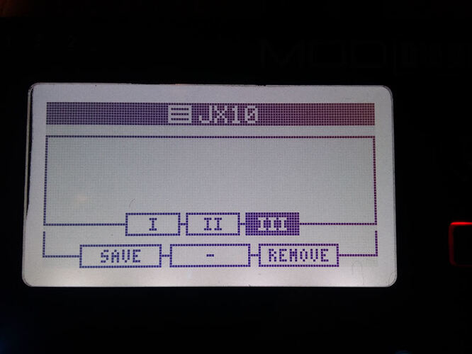

Description
After saving a snapshot and switching back to control mode (B+C), the HMI seems to still be in snapshot mode, leading to a faulty screen.
How to reproduce
- Switch to pedalboard mode (B+C)
- Switch to snapshot mode (A)
- create new snapshot or just overwrite the current entry by pressing SAVE twice
- Switch back to control mode (B+C). The screen should show the controls correctly.
- Try switching to another control page
Expected/suggested solution
The control mode should work normally. (When pressing B+C again the control mode works correctly.)
Additional information
Result screen:
Debug logs (with some comments added):

== pressing B+C for control mode
== (screen switches correctly, there's no log output)
== pressing button 3 to switch to page 3
DEBUG:root:[hmi] received <- b'cs 0 2\x00' | CMD_DWARF_CONTROL_SUBPAGE
DEBUG:root:hmi parameter load subpage
DEBUG:root:[hmi] scheduling -> a 0 "GLIDE" 0 "" 0.720000 1.000000 0.000000 201 0 | CMD_CONTROL_ADD
DEBUG:root:[hmi] sent "r 1"
DEBUG:root:[hmi] sending -> a 0 "GLIDE" 0 "" 0.720000 1.000000 0.000000 201 0 | CMD_CONTROL_ADD
DEBUG:root:[hmi] received <- b'cs 1 2\x00' | CMD_DWARF_CONTROL_SUBPAGE
DEBUG:root:[hmi] scheduling -> a 1 "GLD RATE" 0 "" 0.190000 1.000000 0.000000 201 0 | CMD_CONTROL_ADD
DEBUG:root:[hmi] received response <- b'r 0\x00'
DEBUG:root:[hmi] popped from queue: a 0 "GLIDE" 0 "" 0.720000 1.000000 0.000000 201 0 | CMD_CONTROL_ADD
DEBUG:root:[hmi] sending -> a 1 "GLD RATE" 0 "" 0.190000 1.000000 0.000000 201 0 | CMD_CONTROL_ADD
DEBUG:root:[hmi] received <- b'cs 2 2\x00' | CMD_DWARF_CONTROL_SUBPAGE
DEBUG:root:[hmi] scheduling -> a 2 "GLD BEND" 0 "" 0.860000 1.000000 0.000000 201 0 | CMD_CONTROL_ADD
DEBUG:root:[hmi] popped from queue: a 1 "GLD RATE" 0 "" 0.190000 1.000000 0.000000 201 0 | CMD_CONTROL_ADD
DEBUG:root:[hmi] sending -> a 2 "GLD BEND" 0 "" 0.860000 1.000000 0.000000 201 0 | CMD_CONTROL_ADD
DEBUG:root:[hmi] popped from queue: a 2 "GLD BEND" 0 "" 0.860000 1.000000 0.000000 201 0 | CMD_CONTROL_ADD
== (screen output see photo)
