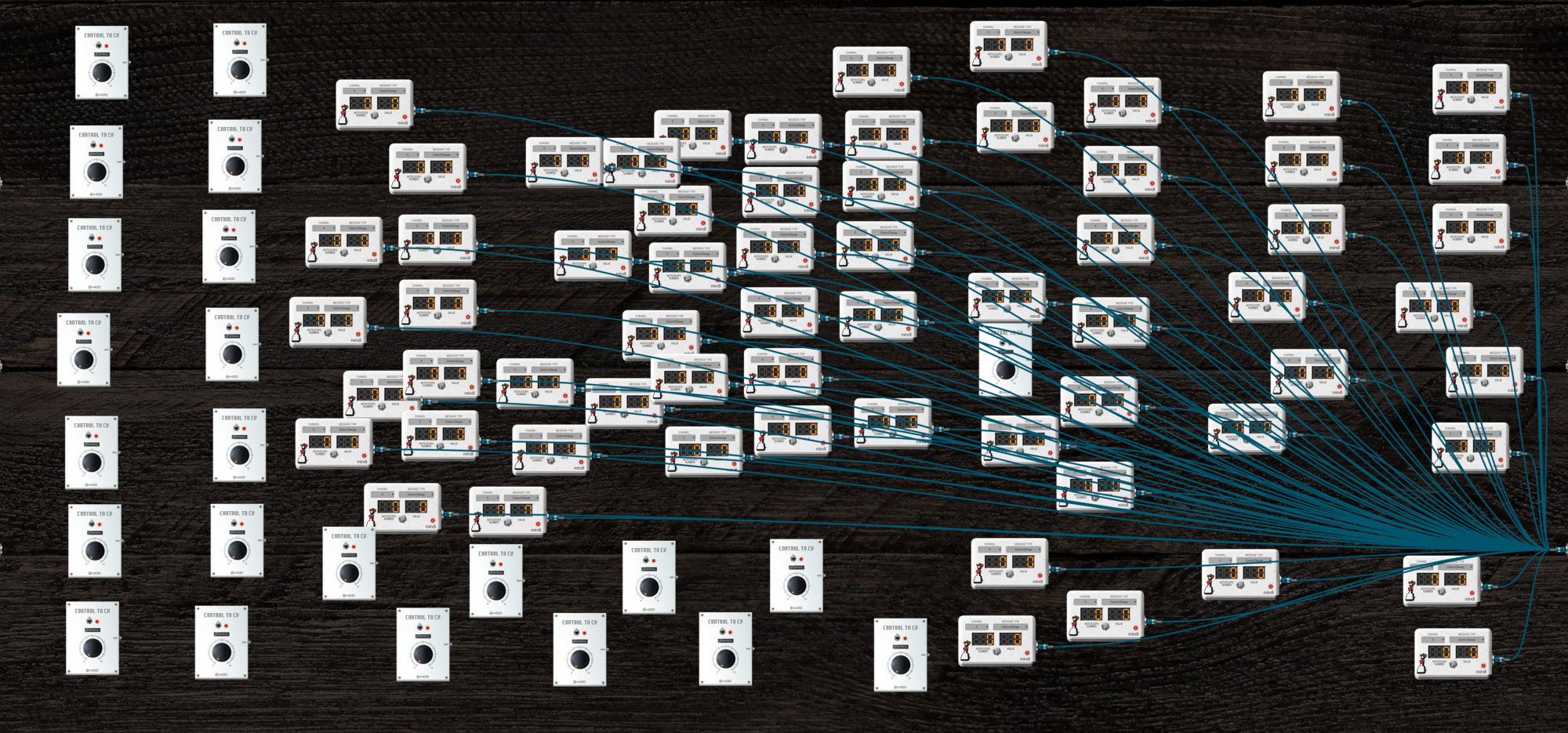

This is how looks pedalboard with MIDI commands for Tonex.
What is nice Dwarf lets to consolidate CC commands - it means that it is possible to use one knob to set for eg MIX of every modulation effect. In tonex mix, rate, depth control of every modulation effect is controlled by different CC command but since Dwarf has Control to CV plugin it is possible to use single knob to do that. It took few hours to make it work properly but now it is a game changer - I can tweak all effects without a need of using tonex sub menus.

Impressive! Out of curiousity – how long did it take you to build that pedalboard, @Lukasz?
will you publish this? It might be the last thing needed to add a tonex to the setup.
hard to say, I did it on few sessions. If you know how midi works and have midi implementation it is not so hard to do.
yes, but I need some time to make it more clearer for other users, so it will be not so hard to assign knobs/footswitches to Dwarf.

I experimented a little bit during the weekend. I got it to work, I will upload the board today. Then you can use it and tweak it like you want.
