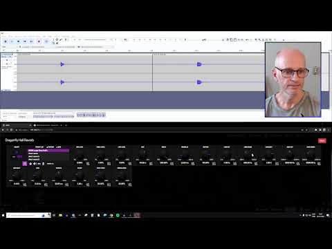

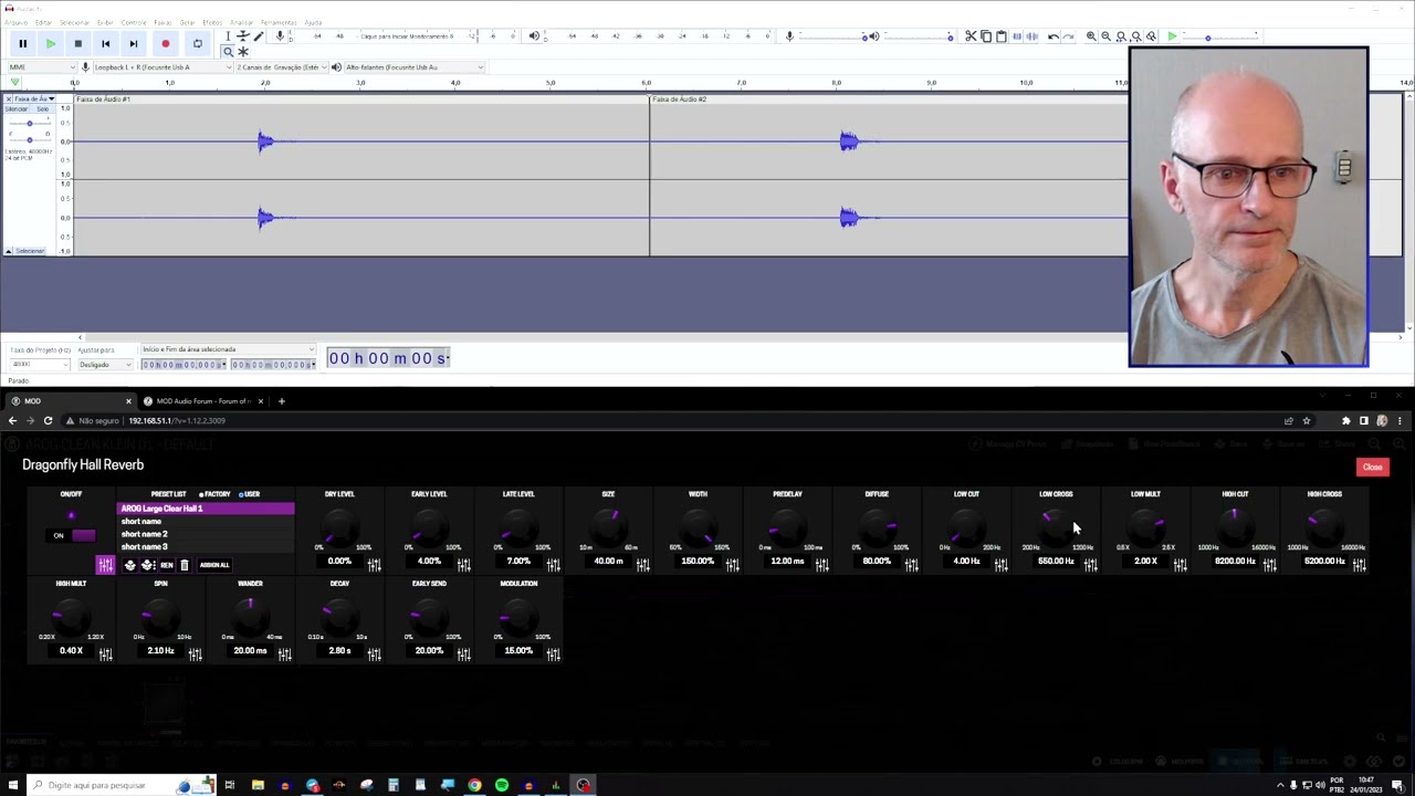

I’ve recorded a short video explaining the odd behaviour of the plugin because I think it’s easier to describe it this way.
Dragonfly Hall Reverb does not commit to saved preset
