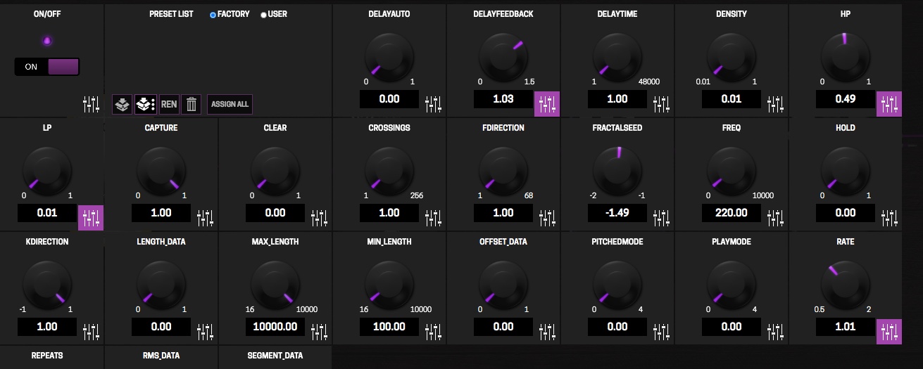

So, I have been exploring the single sample delay feedback loops in gen and loving the results, especially ramping the feedback past 100% and pitch shifting or processing the signal in the feedback loop and sending back into the device, allows for infinitely cascading effects and some very noisy self oscillating systems.
However, when I port onto the Dwarf after a while of the feedback building audio cuts out, and I mean EVERYTHING on the whole pedal board cuts out until I turn the feedback pedal off and audio starts againâŚ
Is there some kind of fail safe built in that cuts out a pedal thats feeding back? If so can I turn that off?

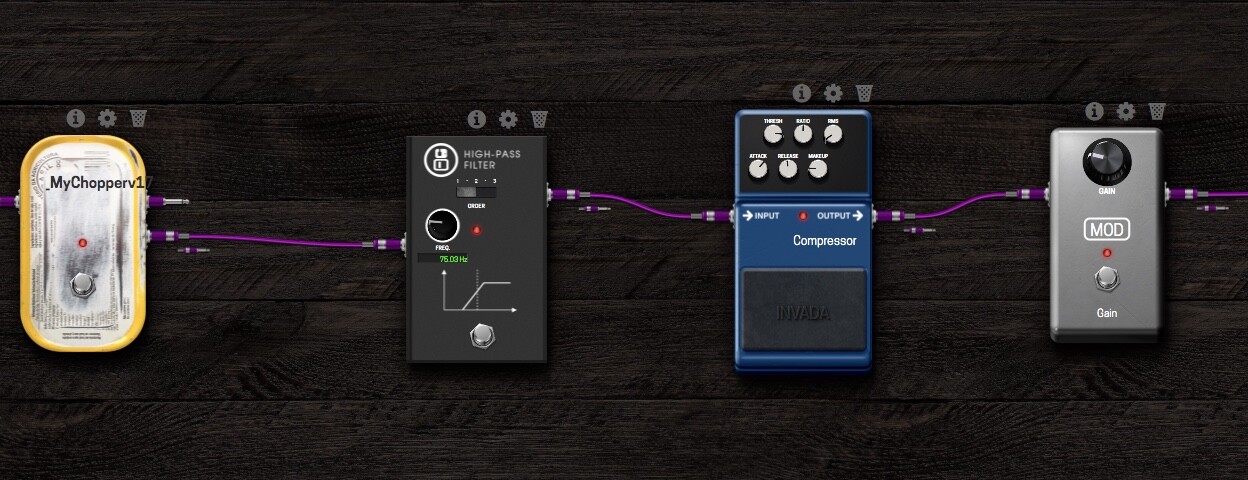

yes, that is how I have it atm, and it works really nicely⌠but the pedal board cuts out completely after a few beats on the Dwarf (itâs fine in Max)âŚ
Itâs like there is some kind of fail safe mechanism that kicks in when the pedal is being fed too hard, ie if the feedback loop is over 100%
Whatâs worse is I donât know how to reset the pedal after this happens other than to turn it off, then delete the said pedal and replace it in the pedal board
Would love to figure this out because it sounds really great when the feedback goes crazy, then boom, no sound!

Have you tried to add a Limiter before the Mod-Gain?
