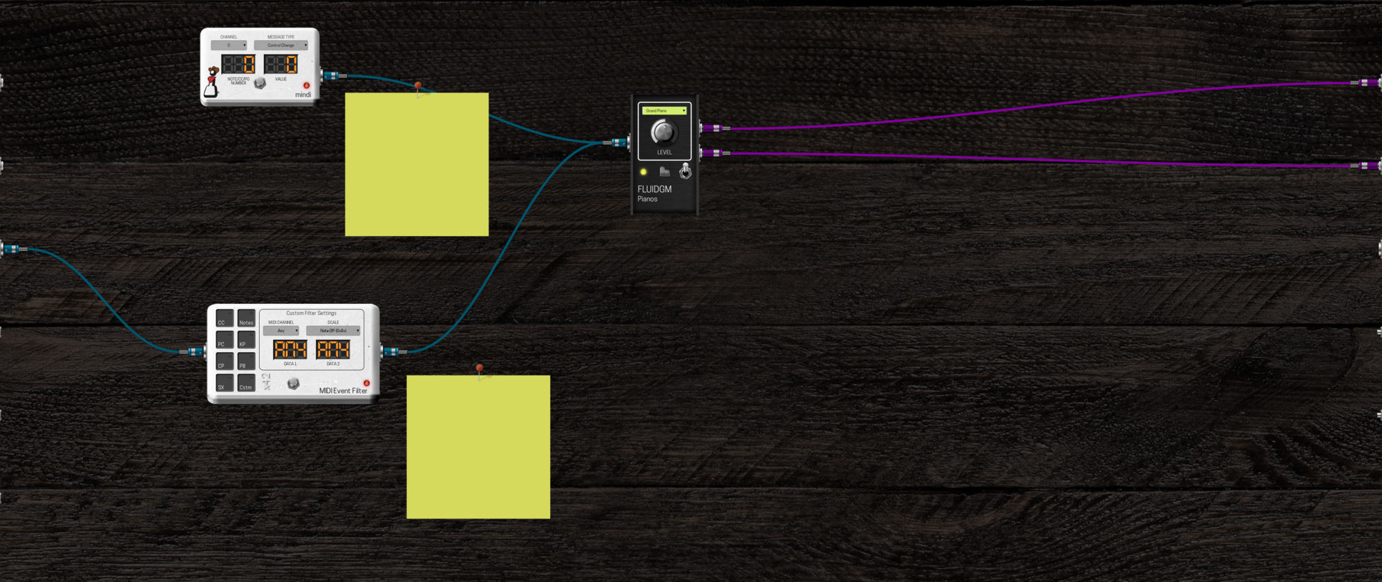

I’m just trying several things. I wanted to know if it came from my keyboards (Akai MPK88, M-AUDIO Keystation and Arturia MiniLab), so I just tried the MIDI Generator in a FLUIDGM Piano effect (see screenshot), and I have the same result, always this modulation effect (like a very loud chorus, or the Modwheel).

Can you try using this pedalboard please?
Just play some MIDI notes from your external controller, and change the value param on MINDI. Please let me know if setting value to 127 gives you the heavy modulation sound, and setting it to 0 gives you the sound with no modulation.
