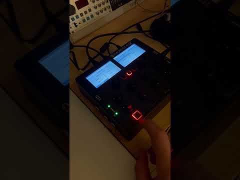

From the video you can see clearly, it works as long as you do not turn off the device, even saving as you can see there will be no more way to make the clock emit, both internal and external

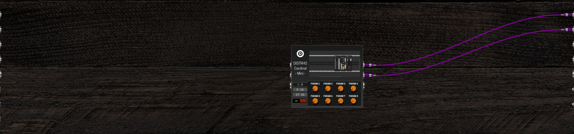

It seems that after loading the pedal board the Mini Cardinal plugin blocks the audio somehow
you are using v1.11.2 yes?
If the cardinal patch is not loaded correctly, the audio does not pass through.
The patch is loaded correctly, in fact the audio passes from the video, the problem is when I close the patch and reopen it. Any slution?
Try saving it as a preset from within the MOD system, in the cardinal plugin settings window.
I tried to save 3 presets, assign all but nothing works, I would like to understand if it is only me who has this problem and I believe it is on the device

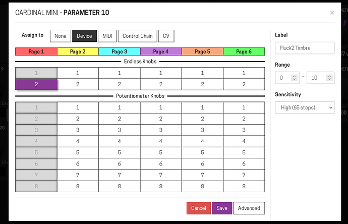

Just one simple question. Is there any way to change the name of the knobs to “param1, param 2…” to something more intutive?
Thank you!
