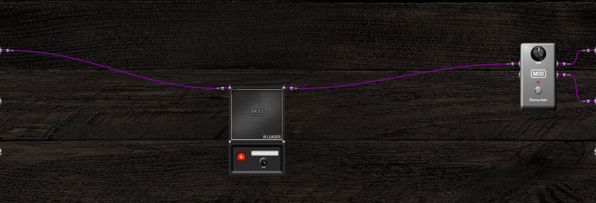

I created a pedalboard so you can also test it and tell me:
