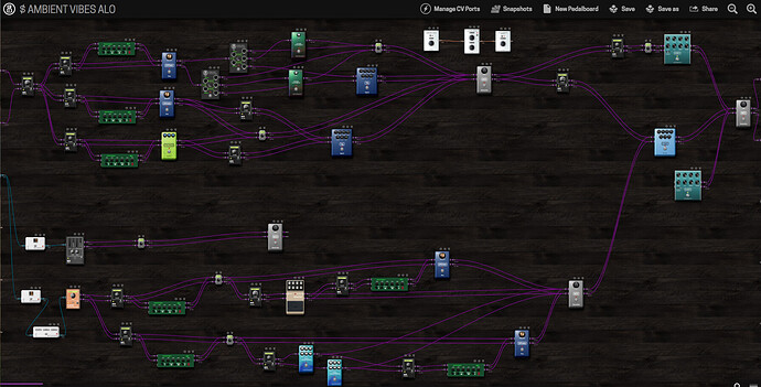

This is a work in progress, so there is a synth in the middle which goes nowhere, but will go to a looper with options to add more loops with controlled effects.
Each instance of ALO is only using the first loop of the batch, but I need separate instances to have separate effects on those. The audio input has three loops currently with no ‘bounce down’ loop. The midi stuff like Vibes has a scale control for different songs, and it’s loops can be bounced down to other loops, and then I clear the initial loops and build up from there.
I think when the looper community see what ALO brings to the Mod Duo, there will be great interest. On the surface having only a stereo pair out from the devices seems like a limit, but if you can do a lot of effect processing in the box, you don’t need extra outputs - just lots of signal paths within the device.
That’s quite a rig! So if I understand correctly ideally we’d have one stereo input, and 6 stereo outputs (one for each loop). Probably at that point the ui would have the loops arranged vertically, and we’d have a toggle switch to route all loops to output 1&2 (so the current functionality), or to their separate outs.
I don’t think there is a need to have a toggle switch to route all loops to a single output within ALO (If that is what you meant), as you can simply wire all outputs to the same destination if you wish. You can also add a toggle or switch plug-in after the ALO if desired. These options already exist. But if it’s easy to add - it also doesn’t hurt, but I wouldn’t add it if the switch generated clicks, or in any way affected latency.
Yeah, all my rigs are large environments. It’s actually quite annoying to edit, as the GUI always zooms out after I do some minor thing. Move a plug-in one inch sideways, bang, I get zoomed out. Turn a knob - bang, I get zoomed out. When I add a plug-in, I can’t place it where I want to, it zooms me out somewhere and the plug-in lands wherever the GUI plops it - quite annoying.
