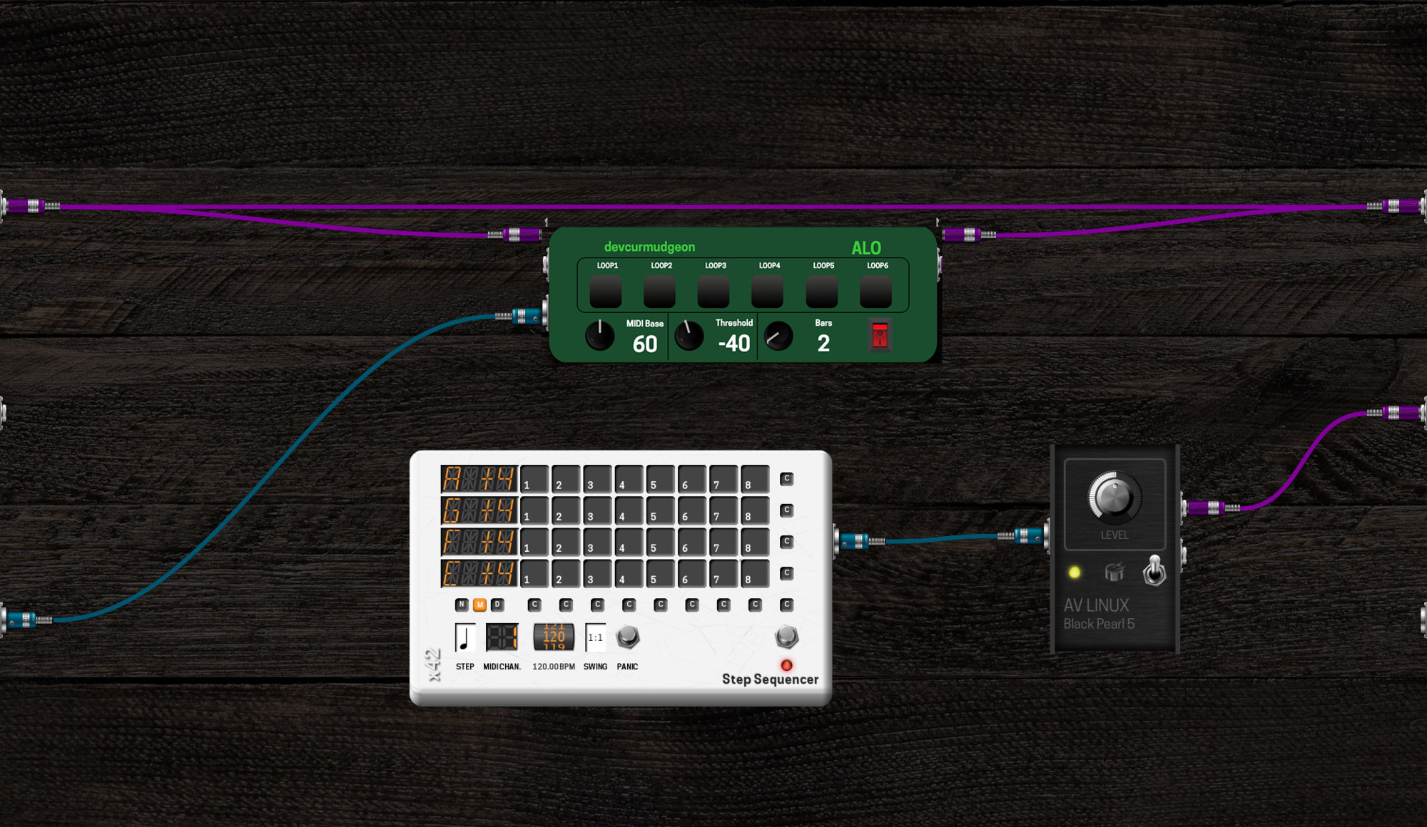

Yes that’s good point, I did not check that before posting :blush: I think it’s on (see picture, the Mod Duo X looks different from what I remember of the Mod Duo).
Just to be clear: the direct guitar goes through (bypass like) when the power on the effect is off (the little red button is dark), but then nothing goes out (i.e. even bypass) when I turn the effect on.
Hi @leDamien
thanks for your encouraging comments.
the direct signal is not passed through when ALO is on - that’s expected behaviour (for me at least :-)). ALO should only output loops, once loops are recorded and active. if you want the direct it’s easy to wire the input straight through in parallel.
if you put an x42 step sequencer on your board, you’ll be able to see for sure if global bpm is running, since it will visibly cycle through the steps.
Good point,
I just did that, with the x42 Sequencer, Set it up to Hot Sync, and when I change the global temp, it shows up the sequencer…
So it’s something else … :frowning:
and it’s just me… It really have been me, because I can make it work. Not sure what I missed initially, but definitely linked to that Global Tempo once again.
Thanks again @devcurmudgeon !!!

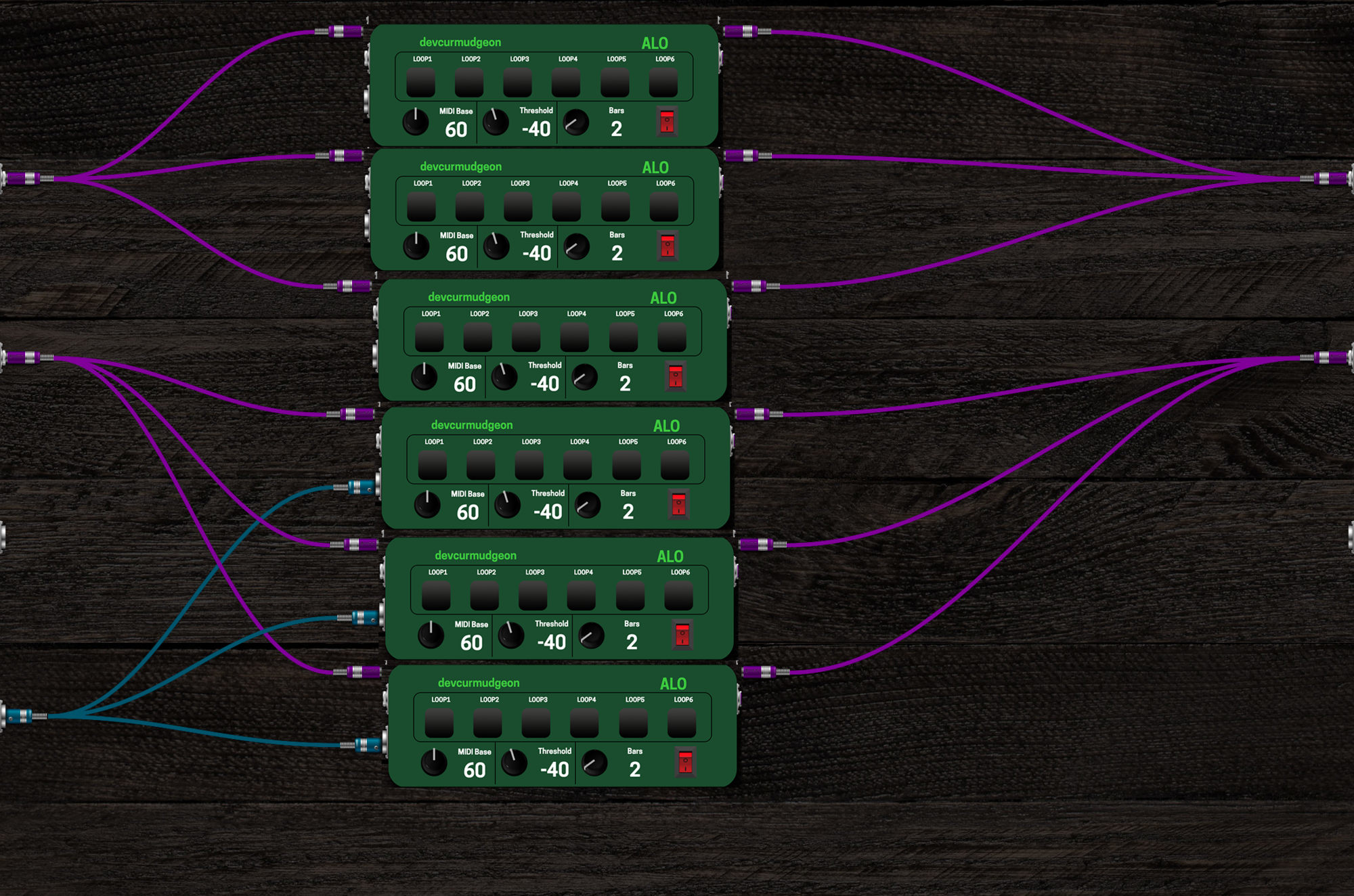

Hi @devcurmudgeon,
as always using a lot the Alo :smiley:
I was wondering about two features that would be useful for me, and wondering if it would make sense to add them.
  • sometimes I’m not sure if I already have a loop stored, so pressing the button would either record a new loop, or play the one stored (very different result). A way to help could be to have an additional color: blue -> loop not playing but being stored
  • when recording a loop, it could be nice to know visually when the recording is finished (I use several ALOs with different bars settings), for example: red when recording, and back to green once it’s playing
