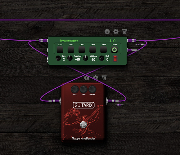

can you share a screen shot or something, would love to see it
I’ve taken a shot at making ALO support this. If you take latest master from github, Loop6 is now an overdub loop, which makes it degradeable - just patch the output through a fuzz/reverb/whatever pedal and wire that back to the ALO input…

Thanks to @BramGiesen the new ALO version is now live in the beta plugins store! :grinning:
In this version Loop6 looks (and behaves) different to the rest when enabled
