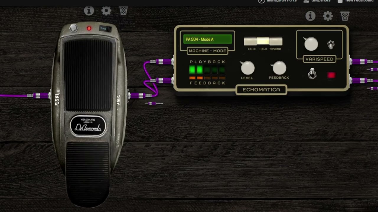

In a continuing effort to recreate the most obscure guitar effects ever made, my version of the Dearmond 610 Volume/Tone pedal from 1961.
A passive pre-cursor to the wah, used by pedalsteel players and rock guitarists such as Dave Gilmour, Jimmy Page and Hank Marvin.
And to the few people who will notice: Yes, on the original device the volume control is operated heel-to-toe and it swivels side-to-side for the tone control. But animating two different actions based on the “volume mode” or “tone mode” would be exceedingly difficult for me (and ultimately pointless). So heel to toe only for this effect!
Intended to be used with an expression pedal.
I made this effect just for my amusement since I can’t imagine anyone caring about a 60-year-old tone control effect from Toledo, Ohio. But I will post it for download this weekend just in case that one other person who cares actually exists. ;D

OK, the plugin finally exists. At first I just modeled the volume and tone sweep as separate modes. But feedback from a user of the actual device and the lore from the Shadows forums convinced me to allow a blend of volume and tone control as well.
This is a pretty obscure and specific piece of gear being recreated and it absolutely needs an expression pedal to be used “properly” so I’m not sure how useful this is to anyone else. But I made it for me and maybe someone else will find a use for it too.
More information and links to the downloads are here: https://websites.umich.edu/~jauge/dearmondo/

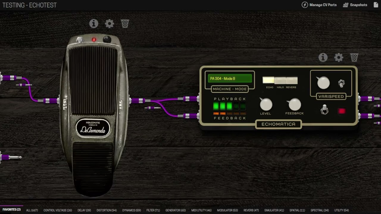

OK, done. version 1.2 adds a CV input! For now, I just have the Linux/Win/RPi versions here:
