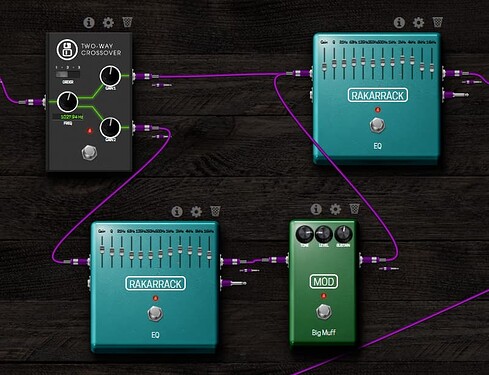

I don’t have a pedalboard to share instantly, but I can advise you to use the Two-Way-Crossover filter when you want to create a good sounding bass-distortion board.
Set the crossover at around 1kHz and only distort the higher frequencies. Then you can use one of the harsher sounding distortions like the CollisionDrive from Brummer or others you like. I also like to add the Rakarrak EQ at the end with the combined paths to highlight the higher frequencies.
Hope this helps a little. May others can also tell how they create their bass distortions. That would be highly interesting for me too. :smiley:

I tried around a little at home, and i think one of the key steps is to apply some EQ before going into the distortion pedal. I don’t have the real thing at home, so I can not A/B it, but this seems to lead in the right direction:
(Had to apply a lot of EQ, since my strings are quite old at the moment :sweat_smile: )
Edit: Input is around -15dB
