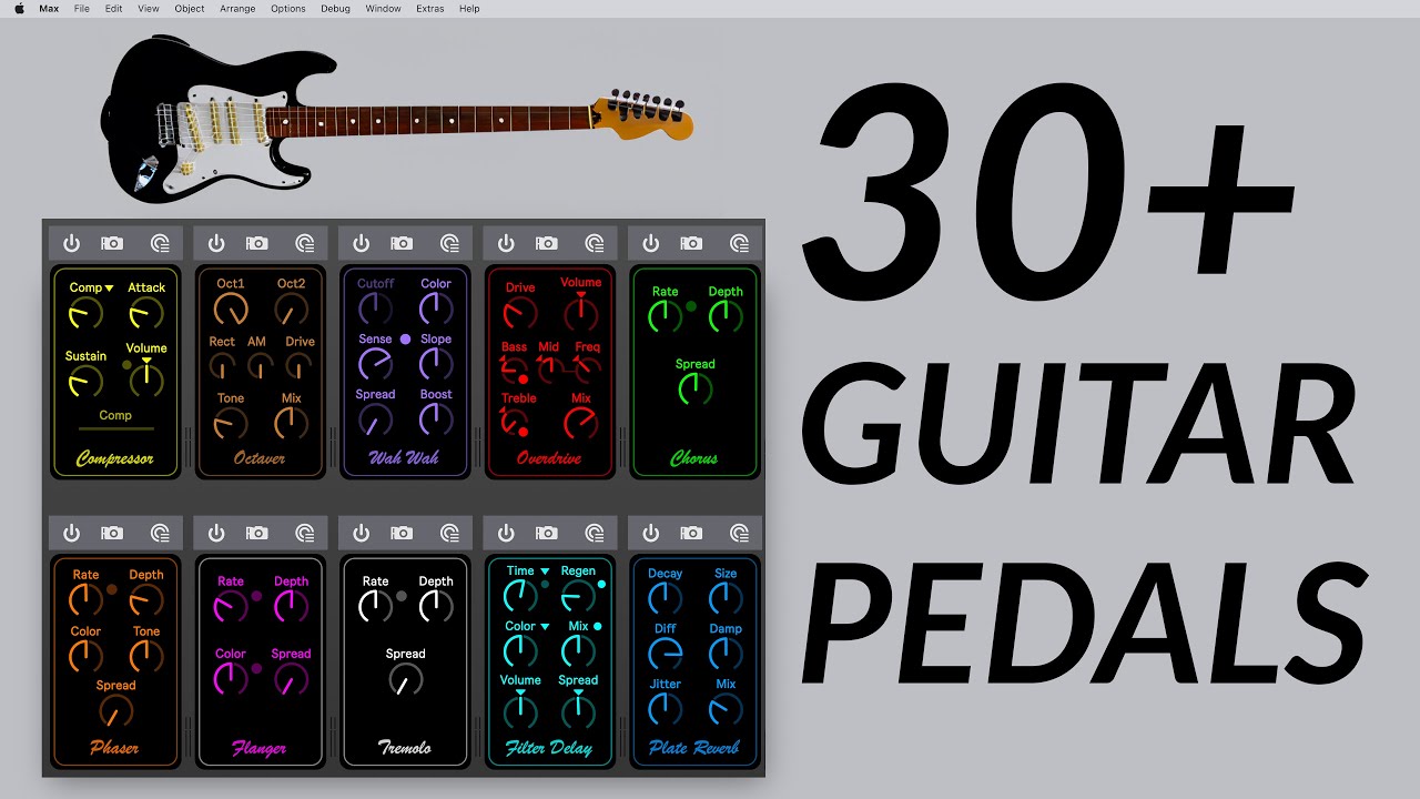

Hey, just starting to discover this a bit, the possibilities seem great. This could be quite an influx of new pedals:
