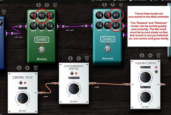

I also have a wish for a CV plug-in. In principle, it is a modification of the LFO plug-in. It is intended to be used to turn the controls of plug-ins (e.g. reverb, delay, etc.) up to a defined point at any speed.
In CV_Tutorial it is shown how to turn a knob of an effect with the AMS LFO2 plugin. The controller is turned back and forth in the form of a sine curve with the help of the LFO plug-in.
My wish for the plug-in would be to limit the running time of the curve. That means, for example, that you only run through the first quarter of the sine curve, then the process stops. If we take the example from the tutorial, this would mean that the controller is only turned up, where it then remains. Only when the LFO plug-in receives a new command does it continue.
Maybe this possibility already exists, but I haven’t found anything about it.

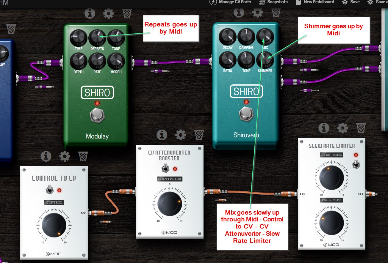

Have you considered if Slew Rate Limiter - MOD Devices could help you achieve the same effect but in a different way?

Hi Danmh,
Your tip with the “Slew Rate Limiter” was excellent! I was actually able to solve my “problem” with it. It didn’t work right away, because I had to realise that the “Control to CV” has a value range from 0 to 10, whereas the “Slew R. L.” has a value range from -5 to 5, but I stuck a “CV attenuator” in between, which adjusts the value ranges. Now I press the footswitch of the midi controller and the mix control of my reverb effect slowly turns up. It works! I am thrilled!
Now the Mix-Knob is turning slowly and smoothly!
Many Thanks again danmh!
I love the Mod platform! Everything is possible in my opinion. You just have to rethink, it works completely different than on real pedalboards.
