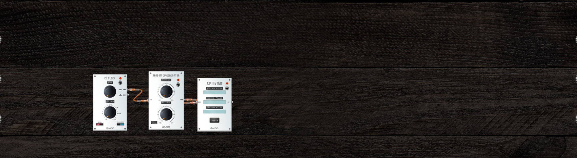

Here is a pedalboard to monitor the problem :
