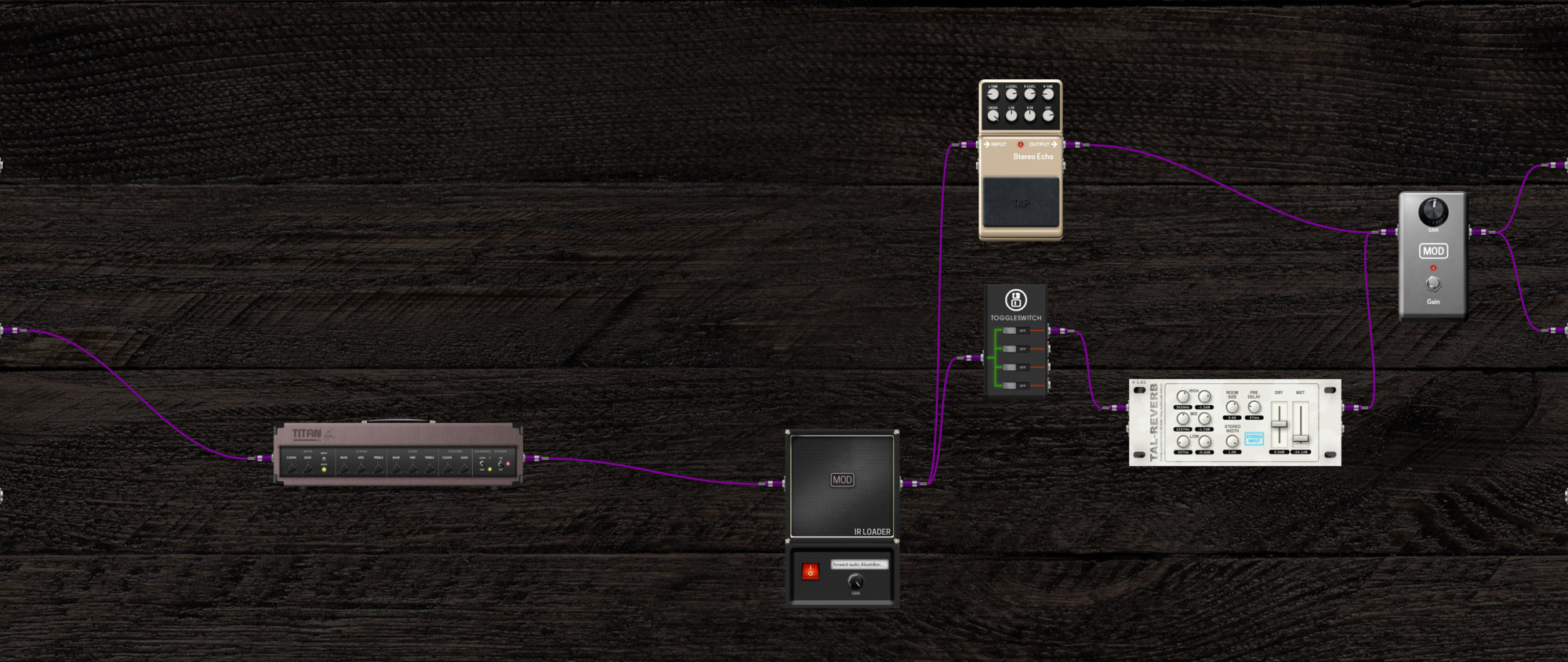

This pedalboard is promising…
The clean channel of the Veja Titan plugin sounds really good and it’s EQ responds really good.
As of now with 128 buffer size the CPU is fluctuating between 70 to 71%
Love it!
It sounds really nice indeed @rogeriocouto

Just shared a new one with a little twist! ![]()
This is as far as I can go with the MOD DUO.
If I add anything else the DUO spikes on the CPU usage and I get X-runs.
I´m starting to think of the MOD DUO as a more specialised unit.
Running fewer plugins to achieve specific sounds with the DUO placed in a larger chain of effects seems to be the way to go since I really like the CPU hungry simulators and reverbs.
As of now I have the DUO as the last unit and I run only a OD and two pedal boosters in front of it.

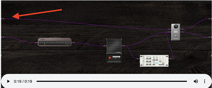

my pedal board is over 95% and i don’t know why… i have put some pedal for my stereo instrument…
someone can help me?
i don’t know why but a i can’t attach snapshop to show you…
thanks
You should investigate by spotting the cpu consuming plugin. Remove 1 plugin at time from the chain. Make sure to not break the chain when a plugin is removed.
Hello @Gabry_Stick
After you identify the plugin that is the culprit just replace it with a similar plugin and check the CPU usage again.
Share your pedalboard here so we can take a look at it.
