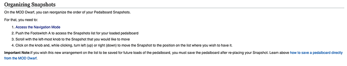

I finally found the explanation, I’m posting the image in case it might be useful to others, thanks.
If I remember correctly, you can do that on the Dwarf itself. If you go to your snapshot list, scroll to the snapshot you want to move, press and hold the knob, then turn it to move the snap where you want it. Repeat for every snap you want to move. When done, save the pedalboard on the Dwarf.

I don’t understand which knob you’re talking about, the knobs are to be assigned to a specific function that escapes me from your description.
@rdomain and @Loris_Donatelli, @AndreasL is actually correct.
Although we don’t have it documented anywhere (which I should fix in the next few days), you can reorganize the snapshots on the MOD Dwarf directly. You just can’t on the MOD WebGUI.
I’m actually not sure when that was implemented, but likely with the 1.13.
I will most likely add it to the MOD Dwarf User Guide
EDIT: actually I just fixed it: MOD Dwarf User Guide - MOD Wiki
