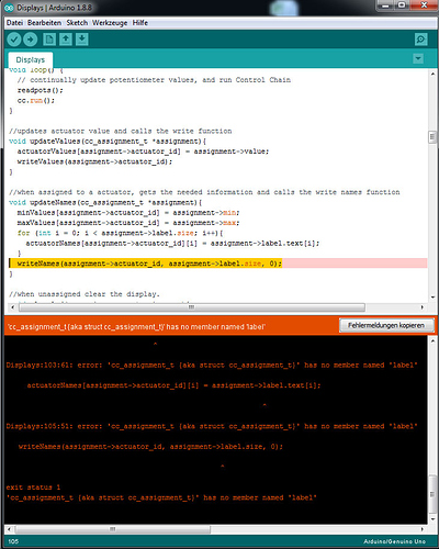

I had some problems getting the Display example for the Arduino Shield running.
First of all, my MODDUO is updated to the latest Version 1.6.2, I also updated everything on the Arduino Uno and I run the Control Chain Protocol Vers. 0.5.1 and of course the TimerOne Lib.
Because the sample code for the “Displays”-example is not included in the Control Chain.zip examples i copied it from the cc-arduino-lib-master (maybe that causes the problem?).
After opening the displays.ino file i let Arduino check the code without making any changes and i get the following error!
It does the same error with ControlChain 0.5.0.
The strange thing is, that i managed to install the whole thing on my laptop with Control Chain v0.5.0 without the error, but when i use 0.5.1 on the laptop i get the same error.
And to complete the confusion: When i use the laptop with the working 0.5.0 Control Chain the Control Chain device immediately disconnects from the MOD after i assigned an effect to one of the actuators. But maybe that is a different problem.
