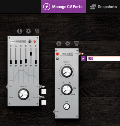

But for some reason, I can’t select or see the CV port of my “control to cv” plugin for the control.
I also tried a LFO plugin without success. What kinda worked was loading the factory preset “CV gen 8th drone”. There I could see a CV port once after I opened the CV port name editor of the according plugin.

Did you perhaps forget to click on “Manage CV Ports” on the top to enable the CV output of the “control to cv” plugin?
For the sake of completeness: Yes, there was a fundamental misunderstanding on my side how CV actually works on the DuoX.
