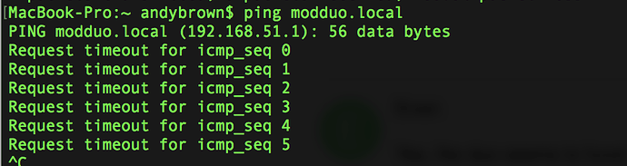

I’m having the same issue. When I ping the ModDuo, I get one response, then it times out…
…and after three reboots now it works. Figures :slight_smile:
Actually the first line is a notification that the process starts send ping-requests to the given address. So you get zero pong-responses.
