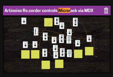

A screenshot of your pedalbord has been generated ? Or is it blank in the pedalboard library ?
Screenshot is generated:
and looks fine.
I’ve also tried to rename the pedalboard so I would not have to rename it when sharing. No improvement.
