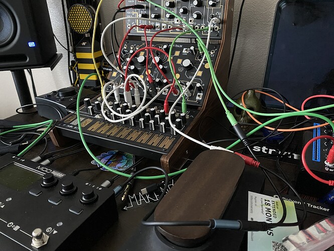

So I’ve been trying to figure out a way to process 2 mono signals from my semi modular gear through one input.
So far I have failed every time.
Right now I’m attempting to use a 1/8” to 1/4” adaptor for the dwarf, with a 1/8th stereo breakout cable into the synths.
Unfortunately I am only able to process the Strega, and hear nothing from my 0-coast with this set up. So I can hear either the left or right mono input, but I can’t get both.
I was hoping to be able to process four mono synths through 2 inputs.
Is this achievable with the MOD Dwarf, or am I failing through the adaptor?
My bluebox allows me to run a stereo or 2 mono inputs off a single jack, and also has 2 mono effects sends out of output #2
I’m still a pretty big noob when it comes to audio and routing. Currently I am just using sends from my bluebox to the dwarf, but that only allows me to apply effects to 2 of my synths at a time.
I’m gonna keep experimenting to see if I can get it to function the way I want, but figured I’d ask about this feature before I dumped more time or money into solving this.
Thanks!

Audio inputs and outputs of the Dwarf are mono, which I think would explain the behaviour you are experiencing.
I think when users refer to using MOD Devices devices in stereo they are routing the 2 independent mono I/O together to achieve a single stereo pair.

Ah, that makes way more sense. I was wondering why there wasn’t a L/R channel on the inputs in the GUI.
Sounds like I need more gear to accomplish what I want :confused:
