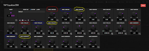

Imagine editing a simple EQ plugin like TAP Equalizer wich the settings window is already uber confusing.
