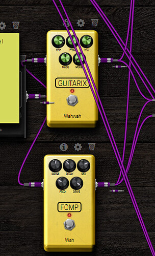

Which autoWah did you tried ? I only tried this one with guitar, the sensitivity should do what you need :
