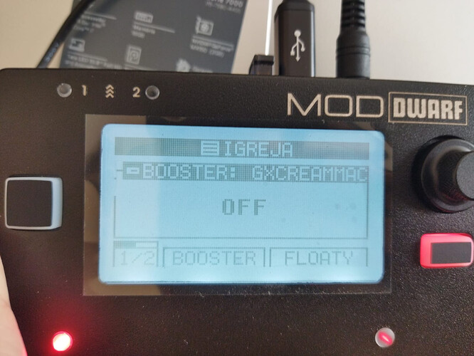

Buggy exibition in Dwarf Display when a label is to long
Description
If I define a long label (greater than 17 chars) for a footswitch, when I change the state, the exhibition appears buggy. Probably is necessary to truncate the text before try to exhibits.
How to reproduce
On mod-ui
  1. Assign a on/off effect to a knob
  2. Go to advanced section
  3. Write a loong text

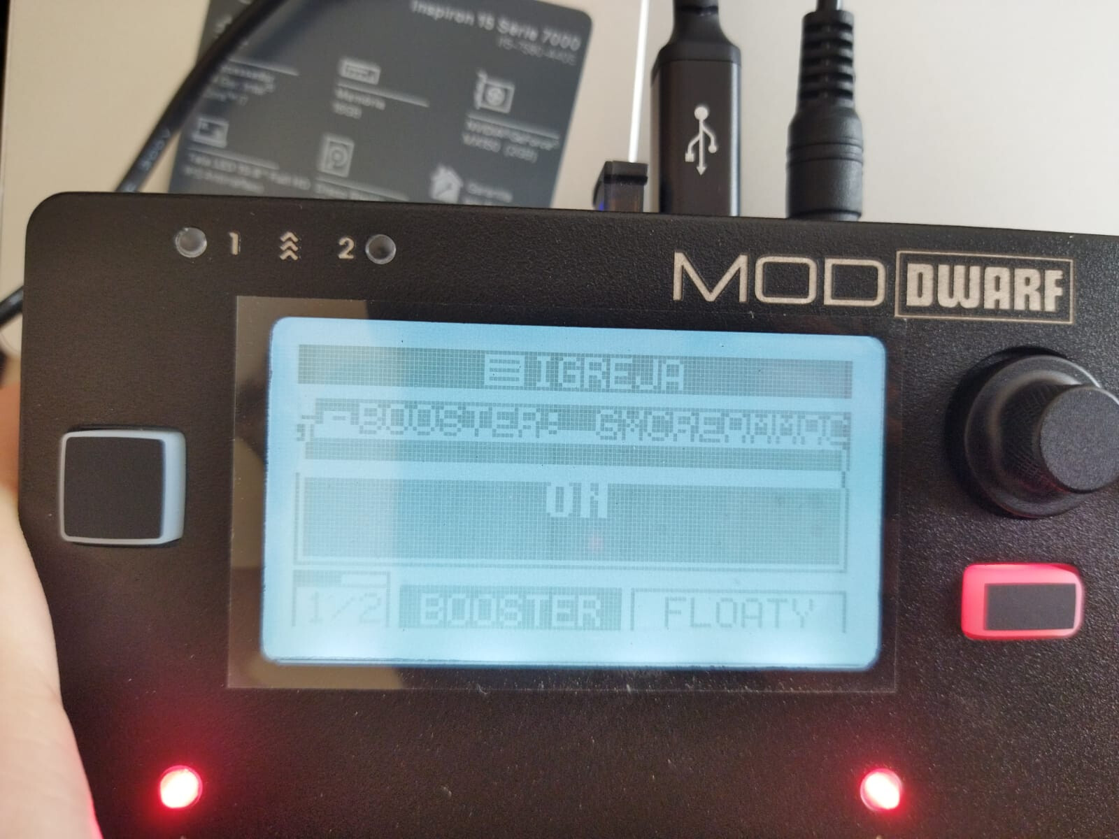

On device, press the related assigned footswitch

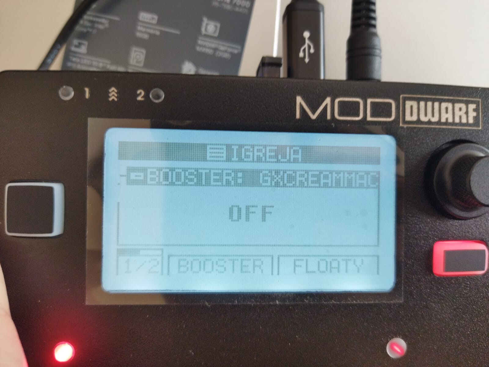

  1. When is to off
  2. When is to on
Expected/suggested solution
Truncate to [0, 17] interval instead the current [0, 19].
Additional information
  • release: 1.11.0.2474-RC1 (it’s a bug related to this RC?)
  • Operating system: It’s related to Dwarf…
  • System version: It’s related to Dwarf…
