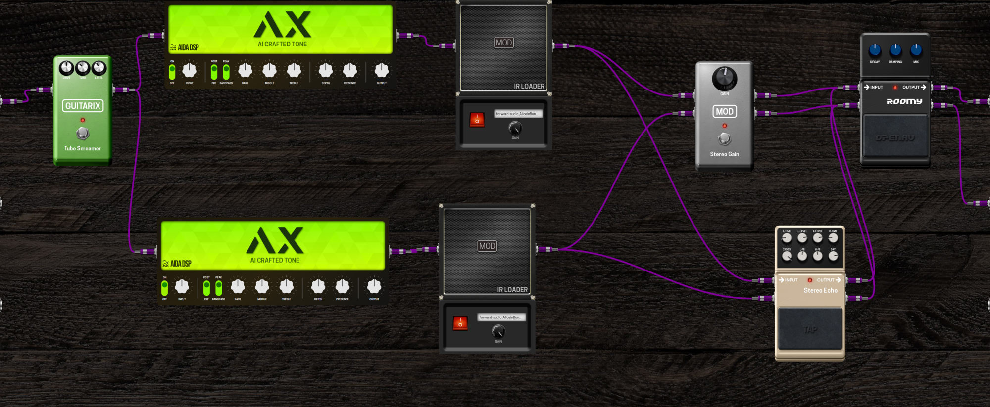

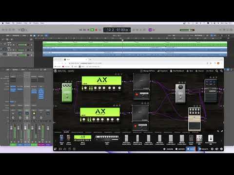

this pedalboard has 2 simply snapshots main and lead, there are 2 different amps standard captures panned. I also tried with light captures but are soooo different from the original.
The hbe sounds really good with a OD in front. Very snarky with percussive riffs - need to record something the next time. Used a YA Mesa 2x12 Mix with my HB Bariton, dropped A, -6db
I had to dial back the input even more to not be overpowered by the bassfreq. But this is also dependend on your personal setup.
The recto is even more bass heavy. But also very usable when dialed in.
Tested with a R446 dropped C with Rockinger Troublemakers.
I used it in 2 songs of my live set with an ESP Eclipse w/EMG in Drop C. Anyway the thing most important in a rig (IMHO) is always the IR (or the speakers)

yeah this sounds amazing!! we need MOAR brutality around here!
I noticed that when I’m not playing anything I get a ton of hum – I’m using double humbuckers but I installed them myself so who knows if I messed up the innards Anyone else getting this? I added a noise gate to the front of the chain and that works well.
You can use also the noisegate built on Dwarf.
Anyway also in phisical amps you will have some kind of noise/feedback on high values of gain: those captures are both at 7 of gain
