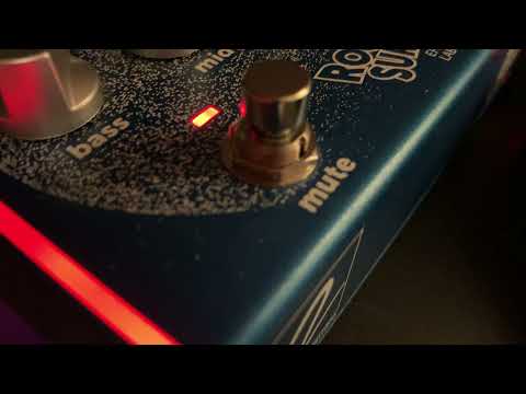

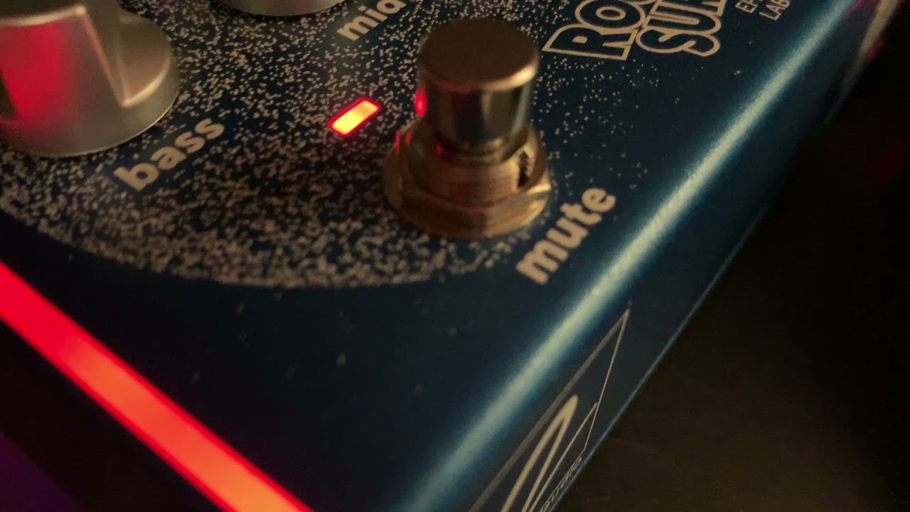

So this is pretty nasty, but I think it’s somehow because I have the dwarf in the effects loop of my amp, with the bass and amp going all through input/output/pedal chain 1, and then the amp DI out to my interface into input 1, then a midi channel into my dwarf, and using input/output/pedal chain 2 going direct from output 2 to my interface channel 2. Which works fine, until I also plug in the usb for the GUI. I’ll likely just find a different way to deal with it all, but if anyone has suggestions I’m all ears!

I’m not sure what’s happening here. That “clank” isn’t quite the sound of a ground loop. From the moment you disconnect the USB I can’t hear that much difference regarding the hum, but that might be because you’re still moving and your chair is also making some noise.
Are you sure you’re not getting some power drain somewhere? This noise resembles when a power source is struggling to keep up with the demand, so it has periodic “drops” that cause a quick, friction type of noise.
That “hum” that is still there when I unplug the USB is actually the fan from the side of the Genz-Benz amp. (it’s sitting sideways on a shelf so the fan is right there). I’m not sure what’s happening either, if I turn off the amp, then the output 2 (synth/mic)is clean through the interface with the USB, but as soon as I turn the bass amp on, it starts up. Any theories on what the “clank” could be?
What I can tell with high probability of certainty is that the clanking is not ground loop. That instead would be an annoying hum.
To figure out where that comes from – which is in turn needed to assess what it is – I would recommend you unplug everything then add one component at a time: Dwarf + computer, Dwarf + amp + computer, and so on. Then you can assess what the source really is.

Well, I tried shifting the Dwarf to before the amp input, and the problem persists. The noise is showing up in the VU in the interface software (the channel was muted in the earlier vid. So it’s definitely coming from the Dwarf, through the amp, and then into the DI. When I unplug the Dwarf to amp input, the noise stops, or if I unplug the USB, the noise stops. Unfortunately I can’t run this setup on battery only, as the interface plugs in (same strip as the amp/Dwarf) and also provides power to the laptop through USB-C. Maybe a bus-powered interface would work, but I would hope that the UA Apollo has some built-in protections to deal with that without causing a problem… I also tried changing from a TRS cable into the amp to an unbalanced one——— As I was typing this I think I fixed it, just realized that the DI out on the back of the amp has a ground lift switch. I hit it and the noise stopped, so it had to be some sort of ground loop… not sure where the clanking came from, or why there was a loop, considering everything in the system was going into the same Furman power strip, but as long as I can get it to work I’m happy…
I thought I had it, but the ground lift switch only lowered the level of the noise by about 20 dB but it’s still showing up at -48 dB. I’m going to try some different cables, but I’m at a bit of a loss. I guess getting a USB hub with an isolating transformer might help— I remember reading at some point that the Mod team was going to roll out a software fix for USB cable noise as part of a system update, @jon, do you know if that’s true, or if it was part of the last release? I’m so close to getting a clean setup, but I’d love to be able to use the GUI and actively play through the Dwarf at the same time while I’m setting up my pedalboards at least. Thanks!
Update, using a Mogami XLR from the DI out into the interface instead of a Cable Matters XLR seems to have dropped the noise below -60! (comes right back up if I turn off the ground lift). I’m hoping this does it, will continue to test it out today, but at the moment I’m cautiously optimistic.
