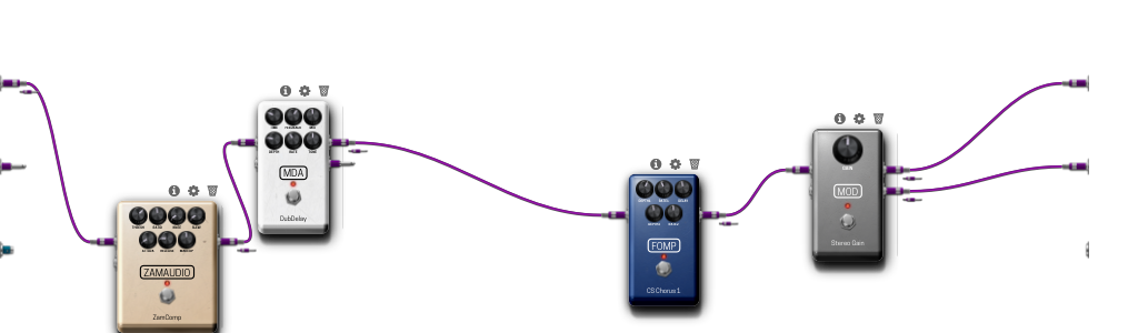

Pedalboard to achieve the mood of Buckethead's Big Sur Moon
This is a companion discussion topic for the original entry at https://pedalboards.moddevices.com//pedalboards/5a6521562564d449761b9a94
Big buckethead fan here! You might want to remove the dubdelay as it does not reproduce the required delay effect. Switch it out for the TAP stereo echo and set the L-delay to 290ms, L-feedback to 50 and dry level to 0 and the cross mode, haas efffect and swap outputs disabled
