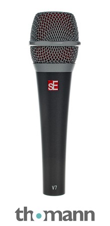

We kind of had the same problem. Not feedback but I record most of our live sessions and wanted to isolate the vocals more from the drums. The SE V7 does a good of that - its constructed a bit different than a SM58 but reduces the background quite a bit. It has a supercardioid polar pattern.
And Its pretty inexpensive and sounds good.
