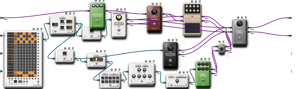

The same sequencer for drums, bass and piano. The presets are assigned to different patterns.

Hey @kikodelmar! Really nice.
So you are triggering different music sections on the sequencer with the pedalboard presets? is that it?
Thank you @rogeriocouto
Exactly. I think the sequencer presets can do the same thing, but they remain in the plugin. I prefer a set of presets in each pedalboard.
It’s not possible to go back and forth in presets, so several presets can point to the same pattern: If the structure is I-IV-I-IV-V… preset 1 is root, preset 2 is the fourth grade and preset 3 is the same as 1 'cause you want to back to the root. (Don’t know if I was clear)
Perfectly clear @kikodelmar
I need to check out the sequencer but I assume that it´s possible to stack more then one sequencer if the number of steps are not enough to accommodate a more complex structure in just one plugin, correct?
I think adding more sequencers you could have more notes, not steps. Plus you have to be aware of them running in sync.
I wonder if it’s hard to make a version with 16 steps and 8 notes, instead of 8x16.
And if you tick two or more steps together it makes the note longer, which is cool, but you can’t play two equal 1/8 notes together.
