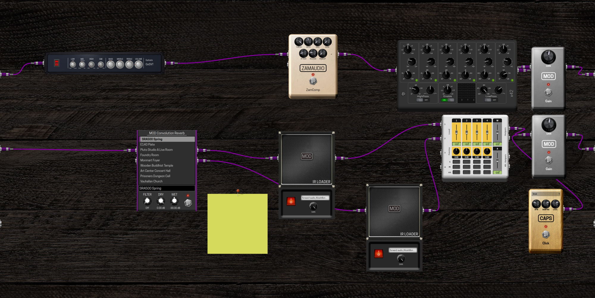

I’m only getting started in understanding how best to use compression, but here’s my current bass pedalboard. I’m happy with the sound for now, but I am always tweaking. I will say that I’m still getting used to the idea that things I play more softly are louder than I expect. I’m used to having built-in compression on my preamp (Eden WT-500 and Eden WTDI), which is usually not nearly as noticeable. For this board, I downloaded some Eden Nemesis 4x10 IRs.
Bob, the most significant parameter for keeping your bass tone feeling more lively is the attack time - set it long so more of the transient gets through before the comp kicks in. I’ll have a rummage before or next lesson and dig out some suggestions from the MOD store :blush:
What goes into the 2nd input - dry bass, preamp? Interesting set up with amp sim on one input and reverb+cab sim on the other.
Any time-based effects can go in-between. I tend to default to splitting things between the 2 channels. In most cases, I end up “jumpering” out 1 to in 2, because I don’t really use many effects for bass. Habits :stuck_out_tongue:
ahh ok like an fx loop, that’s makes sense! very cool
