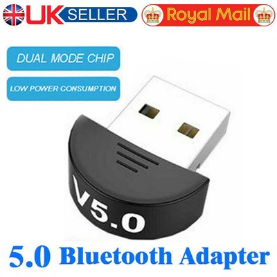

On top of that, before posting the problem, I wanted to try my luck with Bluetooth connectivity. Didn’t even manage to make MOD recognise Bluetooth v5.0 dongle. The device status was - Unsupported (- the Bluetooth version of the dongle in use is too old (needs >= Bluetooth 3 or newer version)) That dongle below:
But his could be an issue with the dongle itself…

Regarding the bluetooth adapter, might just be unsupported yes.
You might be the first to try a BT5.0 adapter.
I also tried one of Amazon and it didn’t work, neither in the DUO or the DUOX, so I used another which was BT4 and it worked fine on both units… I tried a BT5 stick to see if there was any improvement in the connection performance, but with no luck.
Anyway, let’s hope Wifi connection sets this poor BT link to the past very soon :wink:
