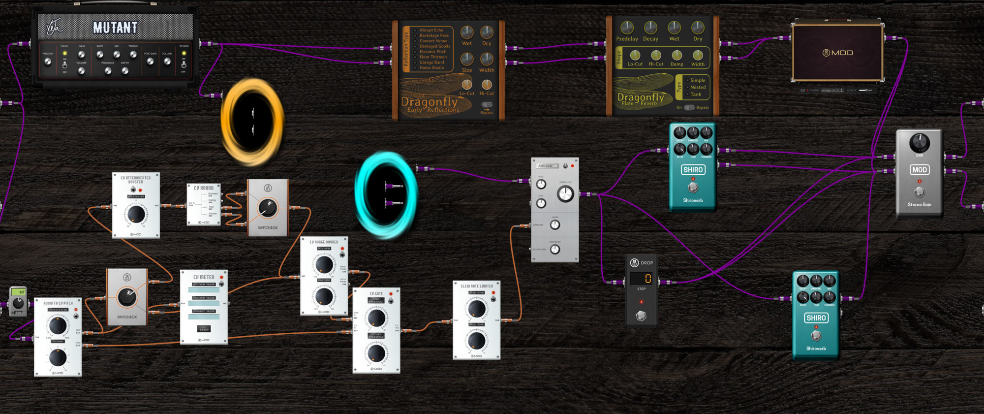

Hi,
snapshots in this pedalboard are setted to match every semitone exits from audio to cv pitch with a range divider so you can save them as preset.
It could be usefull to trigger effect and modulation on specific note.
In this case they are saved as fraction number so it works on every notes inipendently by octave ( if you use a round CV plugin).
Here an example:
The shimmer reverb line is activated only playing C
use values inside previous pedalboard to change the trigger note.

Thanks,
it has a little bit of latency but using it with a slew limiter and think it as emerging effect could be really intresting in composition. If you want trigger the line on a note in a specific octave you have to erase the CV round and add the relative integer to the value in the range divider. Also put plugin before or after the VCA could generate different kind of effects.

good idea, here it is:
I made same changes and put some snapshot.
1: the whole bass E string (and relative notes) will trigger the effect line
2: all C notes will trigger the effect line (as before)
3: only the bass C will trigger the effect line
4: all note between the first and second C will trigger the effect line
I left the CV meter on the pedalboard so you can monitor the voltage in the range of your intrest and put it in the Range divider plugin.
