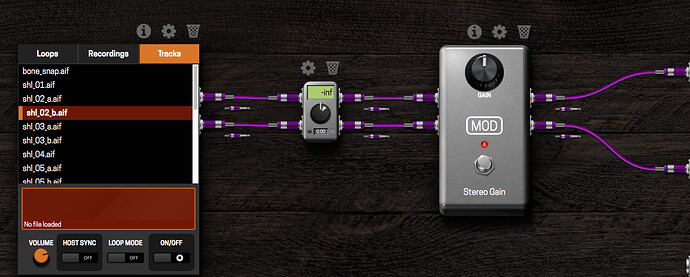

I just loaded some 48k files, and they don’t play at all.
In that bottom section where it says “no file loaded” - should that message go away?
I’ve selected different files, and refreshed the browser, but that message is always there.
48k Aif’s didn’t work for me, but 48K Wavs did, so I will use those.

I’m just getting around to re-testing the features of the audio player.
I can’t see a way to assign a knob to the list which selects the audio files - is this not possible?
I can create presets, but not limit which files are in each preset, so all files on my DUO are always visible.
Ideally we should be able to set up different lists for a few players, then be able to select files from those lists and play the file. A preset per player would allow a list per player.
If selecting files via knob is not possible, then I’m unsure how this is intended to work. Do you just select one file per player, and it’s a single sample per instance?
If you could save whatever audio file is selected, as a preset, that would be a big improvement because you can select presets with a knob, but this just unselects any audio file which is selected, it does not re-select a new audio file, even if you saved the preset with an audio file selected. That seems like a bug because I can’t imagine what a preset would be for this plug-in.
That is a bug indeed.
Presets should load a previously saved file, assuming it still exists.
I was certain this part was working… Will need to check again.
Regarding addressing the file list, this is a known limitation.
It requires some behind-the-scene-things to be done first, which are needed/used for picking individual presets too.
We have this on the roadmap for later this year.
