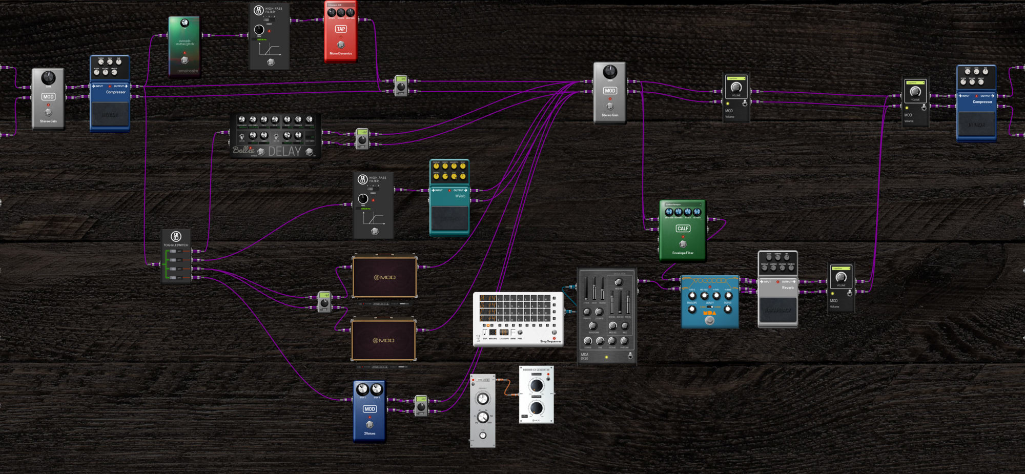

Worked on headphones on a pedalboard:
and suddenly my brain has been kicked out by a incredible loud noise. Output LEDs went red, I threw away the headphones and screamed. Immediately switched off the device. Sadly, because it is hard to know what went wrong this way. Swiched it back on and all was fine. But now I´m afraid of my headphones:(

I uploaded the board (see 1st post) and there only is the random generator in BETA.
I´m still scared of the board and don´t know how to move on. I put the “limiter” (stereo Compressor) at the end AFTER the noise happened. Also now I readjusted the gain-stages thoughout the patch so the overall level is now higher and I could lower the main output. that way the noise- if it happens again- won´t be 1000 times louder than my signal… just about 100 times;)

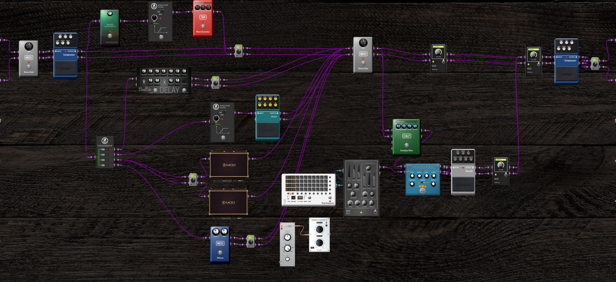

thanks! I did try the pedalboard btw, and confirmed the issue.
I still have a browser tab open with a different one where the same thing happens. Install Pedalboard - MOD Audio
did not check if there are plugins in common between them.

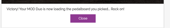

I am not able to load ANY Pedalboard via the online-library.
It shows:
…but nope. No new pedalboard in my library.

those pedalboards are only loaded, not saved in the system.
If you like any of them, save before loading the next one.
thanx, but they are not even loaded.
