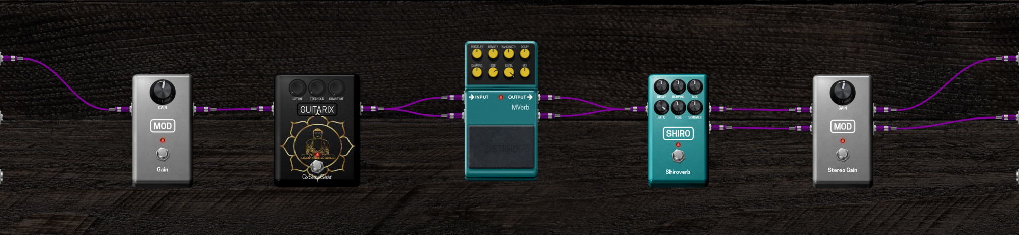

I want to add another use case where you need to assign one footswitch to turn on/off two different plugins. I’m using (and modifying) this pedal board:
to create a sustain/freeze effect. In order to stop the “sustained sound” I need to turn-off reverbs at the same time. Cutting-off the input or output is not enough because the reverb will be sustaining that previous sound until the signal goes does, so I can not control the length of sustain.
Would be a way to stop both reverbs at the same time?
