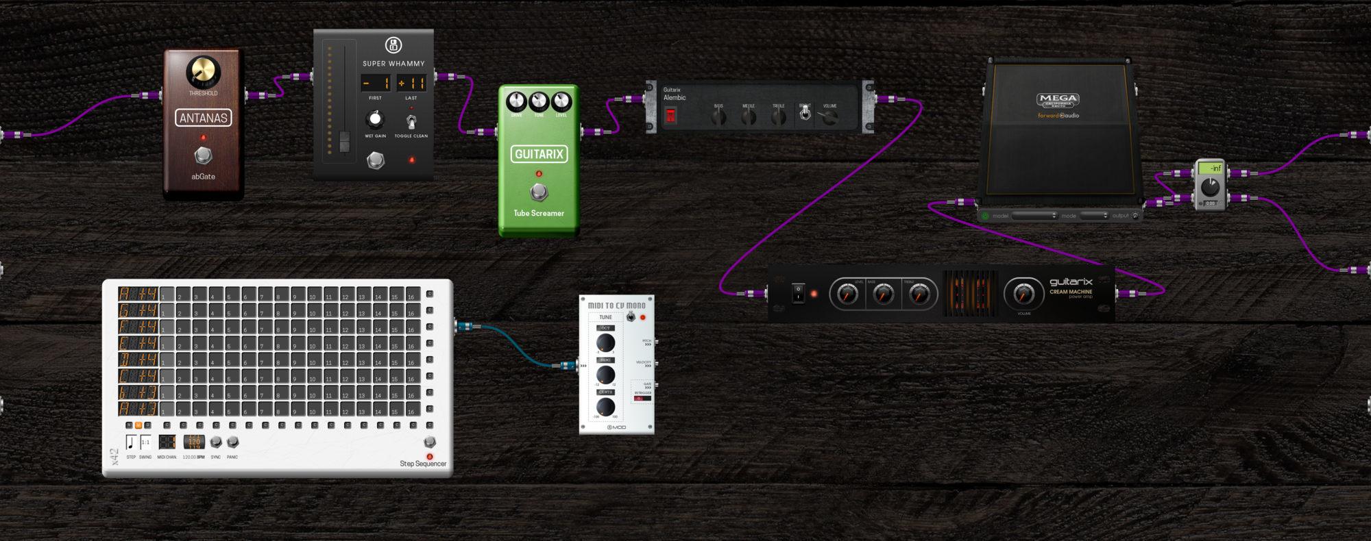

Check this out - you can make arpeggiator with whammy and some mod plugins:
Whoa! Well there’s a learning journey right there. Thank you.
So no Midi input needed, in this case, and Whammy set to be controlled by the CV plugin (which doesn’t need an output). Need to spend some time getting my head round the possibilities …
