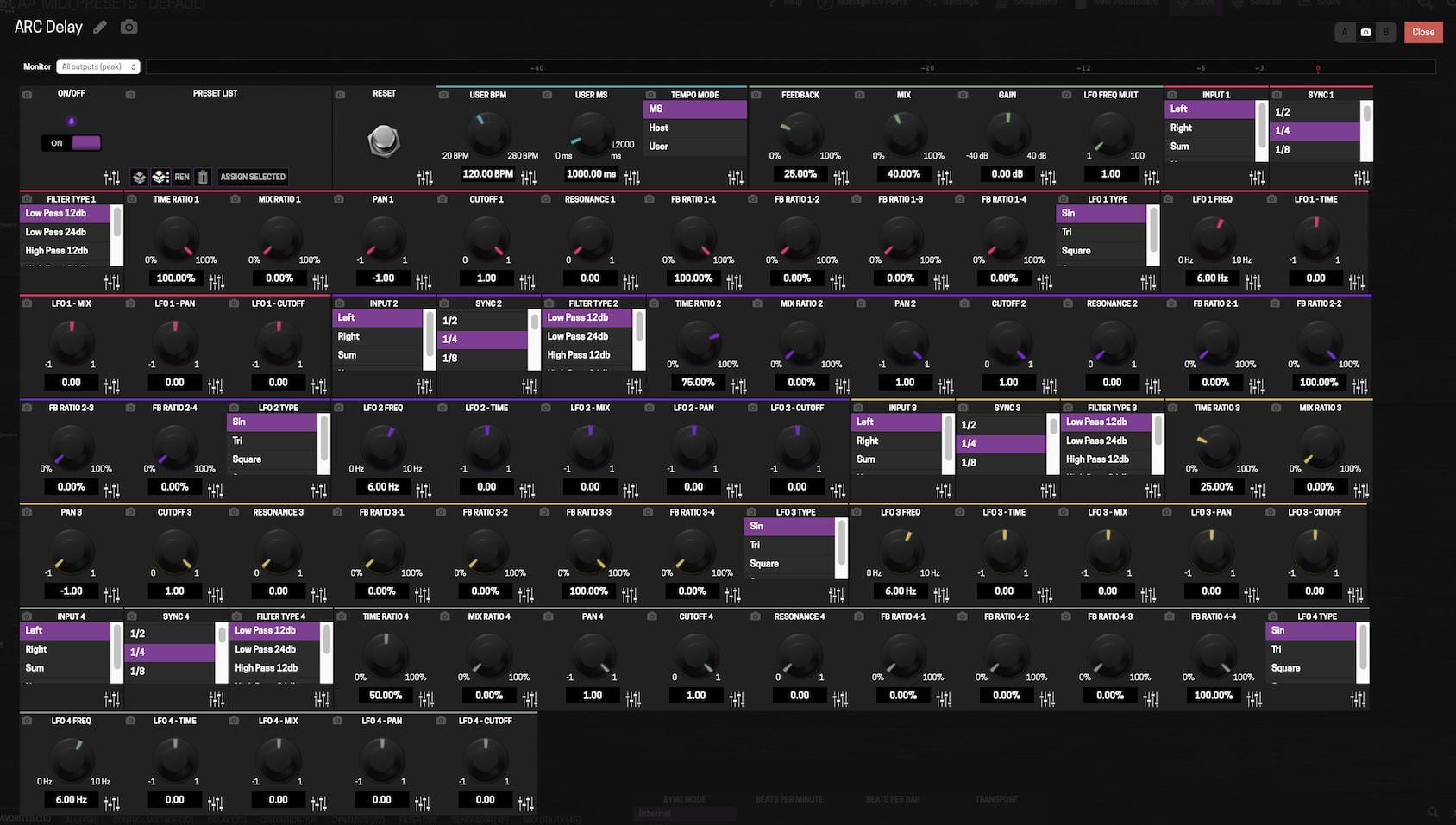

I made this for me really but maybe someone else will be interested.
That is, if you feel the need for a 4 delay line delay with each delay line having a filter on the feedback and an LFO that can modulate time, mix, pan and filter cutoff. Each line can feedback to itself and also the other lines. :slight_smile:

This is one of those cases where port groups are pretty much essential. And actually a GUI could help make this much more manageable. The concept sounds cool though, i might just have to have a play. :wink:

I thought of adding some presets but as it can get absolutely insane I wasn’t sure what sort of stuff to put in!
A simple start would be to turn the MIX RATIO 1 and MIX RATIO 2 up to 100%, set the TEMPO MODE to one of the BPM settings (Host or User) and set the SYNC 2 to 1/4 dot.
Then set both CUTOFFS down to dull the delays, add a little bit of LFO1 - TIME and then start cross feeding by setting FB RATIO 1-2 and FB RATIO 2-1 to 50%.
Then start messing around with the other LFO modulations :slight_smile: The RESONANCE can cause things to get a bit out of hand with large feedback values, the RESET button will clear the delay data if it all goes bananas.
