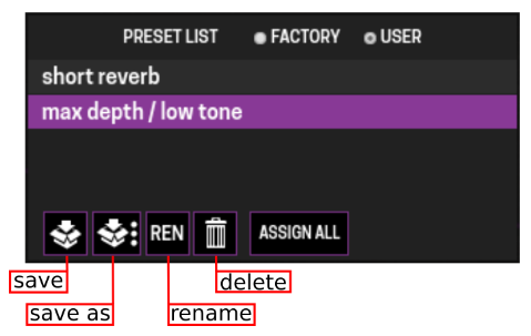

have you tried making plugin presets?
you can assign the preset list to a footswitch

No, I am talking about creating plugin presets.
OH! Thanks! This works great to cycle through different toggle configurations. Is there any way I could get rid of the ‘Default’ preset, where all footswitches are in OFF position?
It does not let you cycle through all four paths unless you set them up as presets like @falkTX suggested.
Deleting factory presets not possible.
In a future update we will let users pick from the preset list for an addressing.
Got it, nevertheless, this helps me a lot. Thank you so much!
